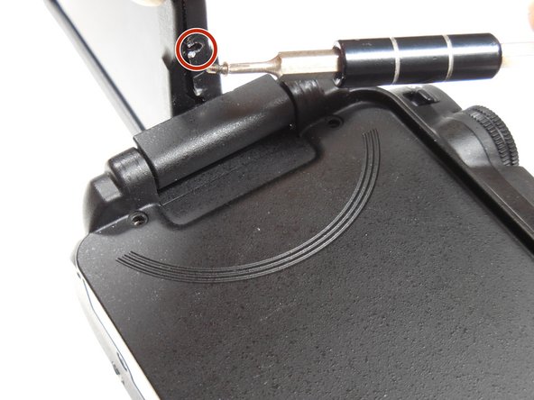

  4. Nikon COOLPIX P7700 LCD Screen Display Replacement: crwdns2935265:04crwdnd2935265:01crwdnd2935265:02crwdne2935265:0 Nikon COOLPIX P7700 LCD Screen Display Replacement: crwdns2935265:04crwdnd2935265:02crwdnd2935265:02crwdne2935265:0
    • Place the camera lens-side down and twist the screen so that it is perpendicular to the camera.
    • Remove the 4.3 mm screw on the side of the casing using the Phillips #00 screwdriver.
    • Twist the screen in the other direction and remove the other 4.3 mm screw.
    • These screws are very brittle! Be careful not to strip the screws. If you find that one has become stripped, follow this guide.
