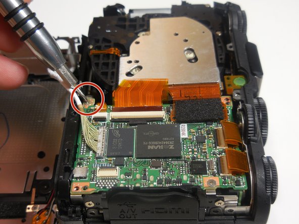

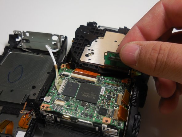

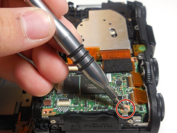

  8. Nikon COOLPIX P7700 Focusing Screen Replacement, Focusing Screen: crwdns2935265:08crwdnd2935265:01crwdnd2935265:01crwdne2935265:0
    • Once the back casing is off, locate the 4.3 mm silver screw near the top of the camera and remove it using the Phillips #00 screwdriver.
  9. Nikon COOLPIX P7700 Focusing Screen Replacement: crwdns2935265:09crwdnd2935265:01crwdnd2935265:01crwdne2935265:0
    • Remove the metal sheet from the camera.
    • It is okay to remove the orange ribbon from the camera.
  10. Nikon COOLPIX P7700 Focusing Screen Replacement: crwdns2935265:010crwdnd2935265:01crwdnd2935265:03crwdne2935265:0 Nikon COOLPIX P7700 Focusing Screen Replacement: crwdns2935265:010crwdnd2935265:02crwdnd2935265:03crwdne2935265:0 Nikon COOLPIX P7700 Focusing Screen Replacement: crwdns2935265:010crwdnd2935265:03crwdnd2935265:03crwdne2935265:0
    • Remove the four 4.3 mm silver screws located on the ends of the chip using the Phillips #00 screwdriver.
  11. Nikon COOLPIX P7700 Focusing Screen Replacement: crwdns2935265:011crwdnd2935265:01crwdnd2935265:02crwdne2935265:0 Nikon COOLPIX P7700 Focusing Screen Replacement: crwdns2935265:011crwdnd2935265:02crwdnd2935265:02crwdne2935265:0
    • Remove the two 4.3 mm silver screws on the far right side of the camera using the Phillips #00 screwdriver.
  12. Nikon COOLPIX P7700 Focusing Screen Replacement: crwdns2935265:012crwdnd2935265:01crwdnd2935265:02crwdne2935265:0 Nikon COOLPIX P7700 Focusing Screen Replacement: crwdns2935265:012crwdnd2935265:02crwdnd2935265:02crwdne2935265:0
    • Lift and detach connector from board as shown.
  13. Nikon COOLPIX P7700 Focusing Screen Replacement: crwdns2935265:013crwdnd2935265:01crwdnd2935265:01crwdne2935265:0
    • Remove the board from the camera to locate lens opening
  14. Nikon COOLPIX P7700 Focusing Screen Replacement: crwdns2935265:014crwdnd2935265:01crwdnd2935265:01crwdne2935265:0
    • Remove the 4.3 mm screws from the metal sheet using the Phillips #00 screwdriver.
  15. Nikon COOLPIX P7700 Focusing Screen Replacement: crwdns2935265:015crwdnd2935265:01crwdnd2935265:01crwdne2935265:0
    • Lift the metal sheet up and out of the camera.
  16. Nikon COOLPIX P7700 Focusing Screen Replacement: crwdns2935265:016crwdnd2935265:01crwdnd2935265:01crwdne2935265:0
    • Locate the reflective lens.
  17. Nikon COOLPIX P7700 Focusing Screen Replacement: crwdns2935265:017crwdnd2935265:01crwdnd2935265:01crwdne2935265:0
    • Remove the lens from the camera.
