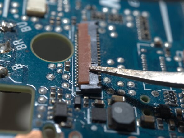

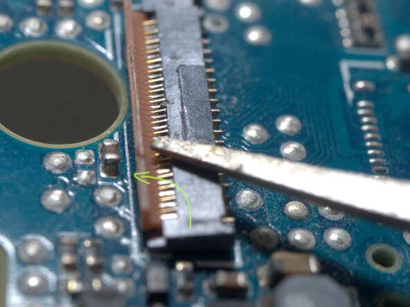

  3. Nikon 1 J5 Main PCB Replacement, Detail of the FPC connector: crwdns2935265:03crwdnd2935265:01crwdnd2935265:03crwdne2935265:0 Nikon 1 J5 Main PCB Replacement, Detail of the FPC connector: crwdns2935265:03crwdnd2935265:02crwdnd2935265:03crwdne2935265:0 Nikon 1 J5 Main PCB Replacement, Detail of the FPC connector: crwdns2935265:03crwdnd2935265:03crwdnd2935265:03crwdne2935265:0
    • The FPC cable is inserted from right side of this photo.
    • Insert a fine tip tweezer or any thin flat tip tool under the latch, and gentally lift it.
    • The latch rotates CCW for about 90 degrees

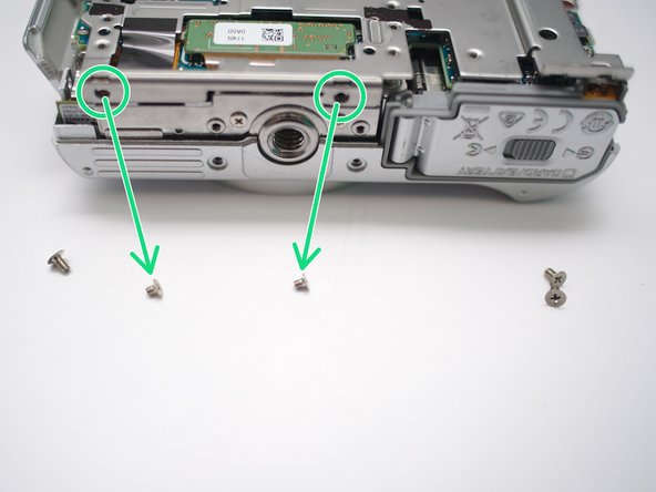

  6. Nikon 1 J5 Main PCB Replacement: crwdns2935265:06crwdnd2935265:01crwdnd2935265:03crwdne2935265:0 Nikon 1 J5 Main PCB Replacement: crwdns2935265:06crwdnd2935265:02crwdnd2935265:03crwdne2935265:0 Nikon 1 J5 Main PCB Replacement: crwdns2935265:06crwdnd2935265:03crwdnd2935265:03crwdne2935265:0
    • Left side, in connector bay, remove 2 screws.
    • Bottom, reomve 2 screws
    • Right side, remove 1 screw

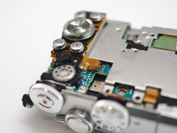

  9. Nikon 1 J5 Main PCB Replacement, Keypad: crwdns2935265:09crwdnd2935265:01crwdnd2935265:03crwdne2935265:0 Nikon 1 J5 Main PCB Replacement, Keypad: crwdns2935265:09crwdnd2935265:02crwdnd2935265:03crwdne2935265:0 Nikon 1 J5 Main PCB Replacement, Keypad: crwdns2935265:09crwdnd2935265:03crwdnd2935265:03crwdne2935265:0

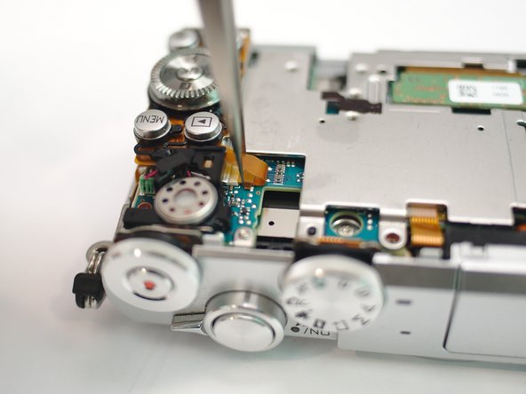

    • Disconnect speaker
    • Disconnect keypad FPC
  10. Nikon 1 J5 Main PCB Replacement: crwdns2935265:010crwdnd2935265:01crwdnd2935265:01crwdne2935265:0
    • Push latches from below
    • pop up and remove keypad.

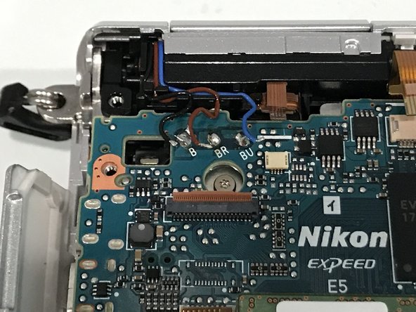

  11. Nikon 1 J5 Main PCB Replacement, Main PCB: crwdns2935265:011crwdnd2935265:01crwdnd2935265:02crwdne2935265:0 Nikon 1 J5 Main PCB Replacement, Main PCB: crwdns2935265:011crwdnd2935265:02crwdnd2935265:02crwdne2935265:0
    • Caution!!! High DC voltage up to 300V
    • Peel tape with an isolated tool (plastic crowbar, plastic tweezers, toothpick etc). DO NOT USE metal tweezers.
    • Use a 2-10kohm 5W resistor to discharge flash condenser, for atleast 10 seconds.
    • Check voltage across 2 points. Make sure it's below 5V DC

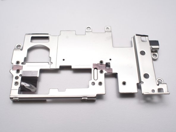

  12. Nikon 1 J5 Main PCB Replacement: crwdns2935265:012crwdnd2935265:01crwdnd2935265:03crwdne2935265:0 Nikon 1 J5 Main PCB Replacement: crwdns2935265:012crwdnd2935265:02crwdnd2935265:03crwdne2935265:0 Nikon 1 J5 Main PCB Replacement: crwdns2935265:012crwdnd2935265:03crwdnd2935265:03crwdne2935265:0
    • Remove 3 screws
    • Remove 2 screws
    • Remove metal frame.

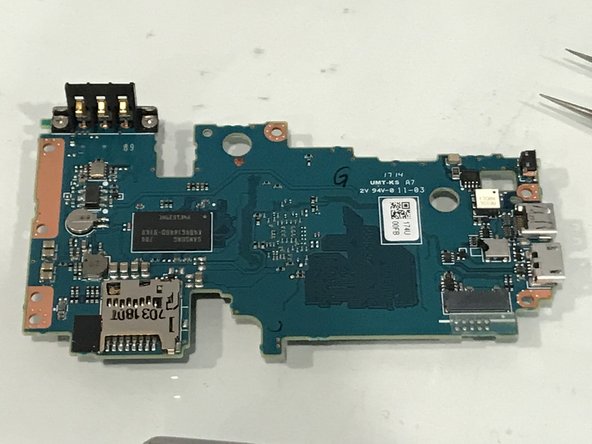

  16. Nikon 1 J5 Main PCB Replacement, Remove Main PCBA: crwdns2935265:016crwdnd2935265:01crwdnd2935265:02crwdne2935265:0 Nikon 1 J5 Main PCB Replacement, Remove Main PCBA: crwdns2935265:016crwdnd2935265:02crwdnd2935265:02crwdne2935265:0
