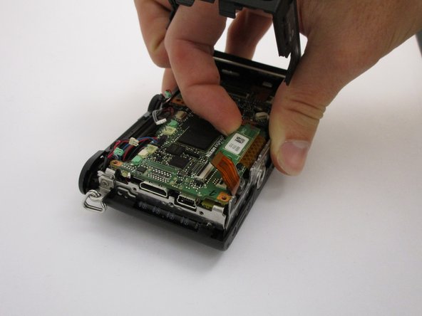

    • Lift up the screen, and use a Phillips #000 screwdriver to remove the (6) six screws holding down the underlying metal plate.
  4. Nikon 1 J3 Motherboard Replacement: crwdns2935265:04crwdnd2935265:01crwdnd2935265:01crwdne2935265:0
    • Pull back the black switch holding the orange screen ribbon in place, and remove the screen.

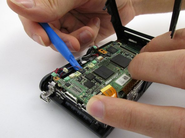

  5. Nikon 1 J3 Motherboard Replacement, Motherboard: crwdns2935265:05crwdnd2935265:01crwdnd2935265:03crwdne2935265:0 Nikon 1 J3 Motherboard Replacement, Motherboard: crwdns2935265:05crwdnd2935265:02crwdnd2935265:03crwdne2935265:0 Nikon 1 J3 Motherboard Replacement, Motherboard: crwdns2935265:05crwdnd2935265:03crwdnd2935265:03crwdne2935265:0
    • Use the plastic opening tool to pry off the connectors shown
    • Using your finger, pry off the connection flap.

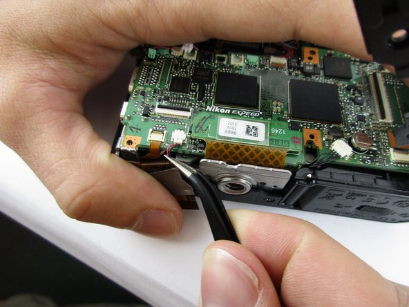

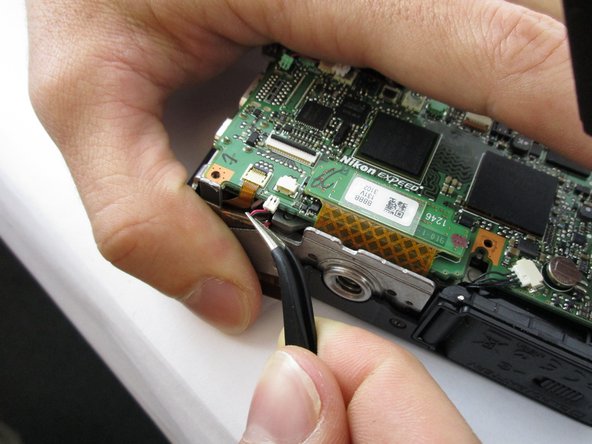

  6. Nikon 1 J3 Motherboard Replacement: crwdns2935265:06crwdnd2935265:01crwdnd2935265:03crwdne2935265:0 Nikon 1 J3 Motherboard Replacement: crwdns2935265:06crwdnd2935265:02crwdnd2935265:03crwdne2935265:0 Nikon 1 J3 Motherboard Replacement: crwdns2935265:06crwdnd2935265:03crwdnd2935265:03crwdne2935265:0
    • Using tweezers, pull out the shown connectors
  7. Nikon 1 J3 Motherboard Replacement: crwdns2935265:07crwdnd2935265:01crwdnd2935265:01crwdne2935265:0
    • Pull back the black switches holding the connecting ribbons in place, and pull out the ribbons.
    • Remove the motherboard.
