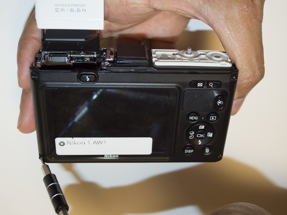

    • Using the Phillips PH00 screwdriver, remove the six 4.0mm screws marked in red. Then remove the panel cover by lightly pulling it off.

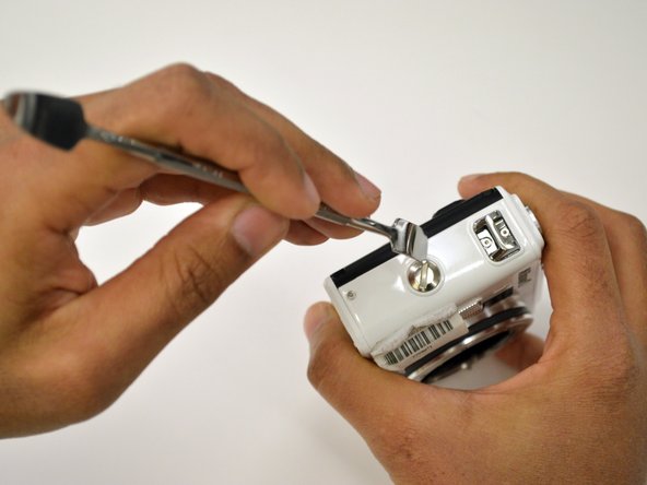

    • Using the Phillips PH00 screwdriver, remove the four 5.5mm screws in the red circles. Then use a plastic opening tool to pry off the tripod socket.
    • Remove the metal plate to have access to the 4.9mm screw under the orange circle, use the Phillips PH00 screwdriver to remove it.

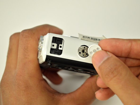

  3. Nikon 1 AW 1 Rear Panel Replacement: crwdns2935265:03crwdnd2935265:01crwdnd2935265:03crwdne2935265:0 Nikon 1 AW 1 Rear Panel Replacement: crwdns2935265:03crwdnd2935265:02crwdnd2935265:03crwdne2935265:0 Nikon 1 AW 1 Rear Panel Replacement: crwdns2935265:03crwdnd2935265:03crwdnd2935265:03crwdne2935265:0

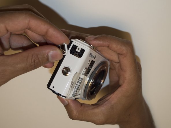

    • Using a T4 head screwdriver remove the three 5.4mm screws marked with the red circles.
    • Use a 1/4" flathead screwdriver or a flat head tool to release the grip attachment screw.
    • Remove the camera strap eyelet.

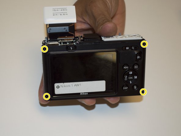

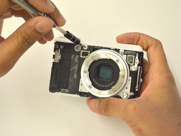

  5. Nikon 1 AW 1 Rear Panel Replacement: crwdns2935265:05crwdnd2935265:01crwdnd2935265:03crwdne2935265:0 Nikon 1 AW 1 Rear Panel Replacement: crwdns2935265:05crwdnd2935265:02crwdnd2935265:03crwdne2935265:0 Nikon 1 AW 1 Rear Panel Replacement: crwdns2935265:05crwdnd2935265:03crwdnd2935265:03crwdne2935265:0
    • Use a T4 screwdriver to remove the three 5.4mm screw marked with the red circles and the eyelet strap.

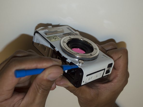

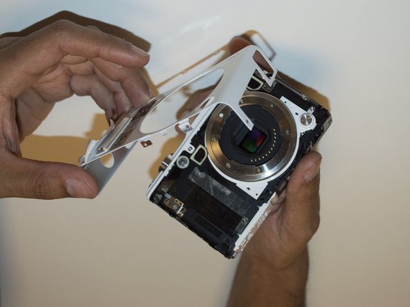

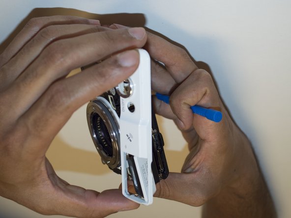

    • Use a plastic opening tool to lift the front camera cover off.

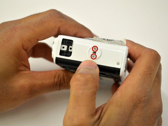

    • Use a Phillips PH00 to unscrew the two 3.5mm screws in red.

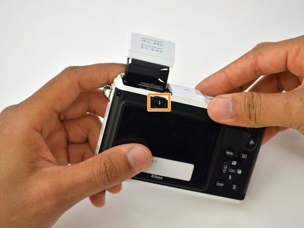

    • Press the flash pop-up button in the orange rectangle to be able to remove top cover of the camera.

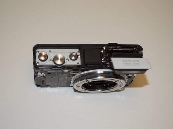

    • Use a plastic opening tool to lift off the top panel.
  8. Nikon 1 AW 1 Rear Panel Replacement: crwdns2935265:08crwdnd2935265:01crwdnd2935265:01crwdne2935265:0

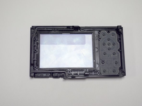

    • If you needed to replace any buttons, you may now do so by pulling them off.

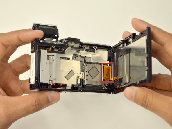

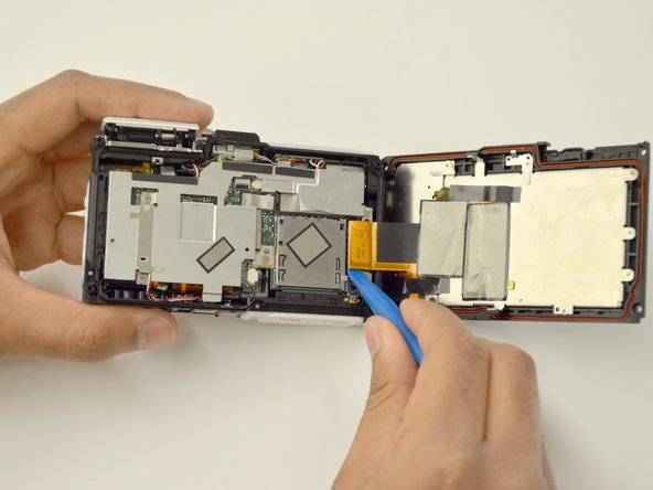

    • Separate rear panel from the camera main body, starting from the HDMI and USB connector side. Do NOT pull the rear panel completely off of the camera yet.
    • Use a plastic opening tool to pry out the connector marked in red.

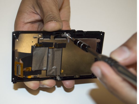

  13. Nikon 1 AW 1 Rear Panel Replacement: crwdns2935265:013crwdnd2935265:01crwdnd2935265:03crwdne2935265:0 Nikon 1 AW 1 Rear Panel Replacement: crwdns2935265:013crwdnd2935265:02crwdnd2935265:03crwdne2935265:0 Nikon 1 AW 1 Rear Panel Replacement: crwdns2935265:013crwdnd2935265:03crwdnd2935265:03crwdne2935265:0

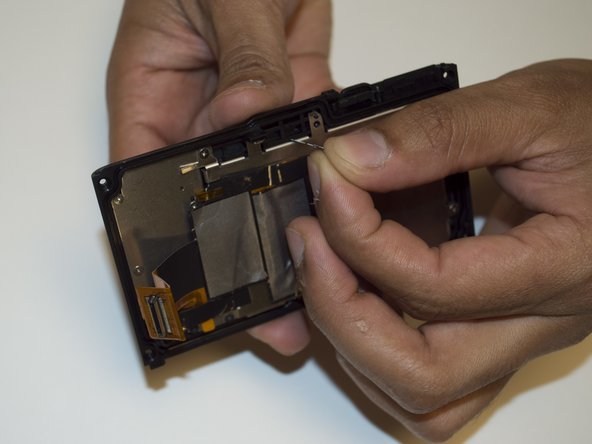

    • Lift the rainbow cable to have access to the 3.1mm screw beneath it and unscrew it with a Phillips PH00 screwdriver.

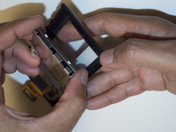

    • Turn aside the LCD screen but do not completely remove it yet.

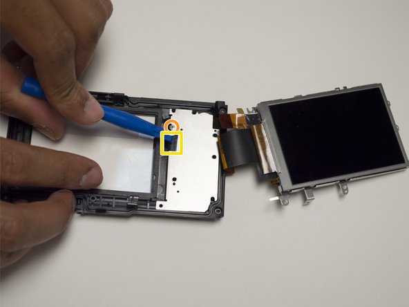

    • You will need to lift the sticky patch inside the the yellow rectangle, to access the 3.1mm screw marked in orange, remove it with Phillips PH00 screwdriver, then you will be able to separate the LCD screen from the rear panel.
  14. Nikon 1 AW 1 Rear Panel Replacement: crwdns2935265:014crwdnd2935265:01crwdnd2935265:03crwdne2935265:0 Nikon 1 AW 1 Rear Panel Replacement: crwdns2935265:014crwdnd2935265:02crwdnd2935265:03crwdne2935265:0 Nikon 1 AW 1 Rear Panel Replacement: crwdns2935265:014crwdnd2935265:03crwdnd2935265:03crwdne2935265:0

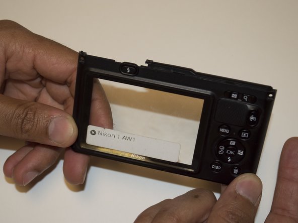

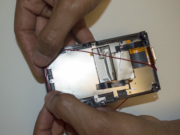

    • Remove the back panel apart from LCD screen.
