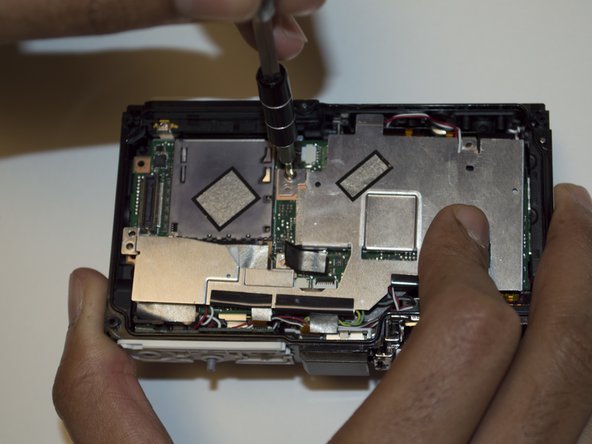

  15. Nikon 1 AW 1 Motherboard Replacement, Motherboard: crwdns2935265:015crwdnd2935265:01crwdnd2935265:03crwdne2935265:0 Nikon 1 AW 1 Motherboard Replacement, Motherboard: crwdns2935265:015crwdnd2935265:02crwdnd2935265:03crwdne2935265:0 Nikon 1 AW 1 Motherboard Replacement, Motherboard: crwdns2935265:015crwdnd2935265:03crwdnd2935265:03crwdne2935265:0
    • Use a Phillips PH00 screwdriver to remove the four 4.4mm screws marked in red.
    • You will need to lift the sticky patch to have access to the screws under it.
    • Use a Phillips PH00 screwdriver to remove the two 6.3mm screws marked in orange.

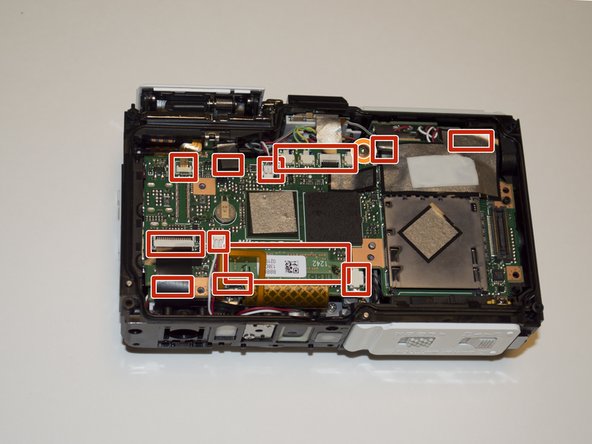

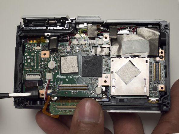

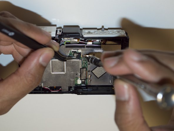

  16. Nikon 1 AW 1 Motherboard Replacement: crwdns2935265:016crwdnd2935265:01crwdnd2935265:03crwdne2935265:0 Nikon 1 AW 1 Motherboard Replacement: crwdns2935265:016crwdnd2935265:02crwdnd2935265:03crwdne2935265:0 Nikon 1 AW 1 Motherboard Replacement: crwdns2935265:016crwdnd2935265:03crwdnd2935265:03crwdne2935265:0
    • Pull off the metal cover to gain access to the motherboard.
    • Remove the connectors first using precision tweezers. In total you will remove fifteen connectors wires.
    • Some connectors are under the sticky patch, be sure you remove all of them.
    • Use a Phillips PH00 screwdriver to remove the 4.3mm screw holding the motherboard to the main camera body.

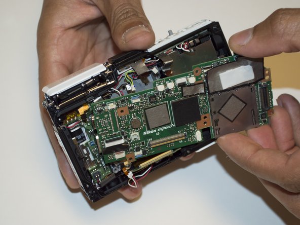

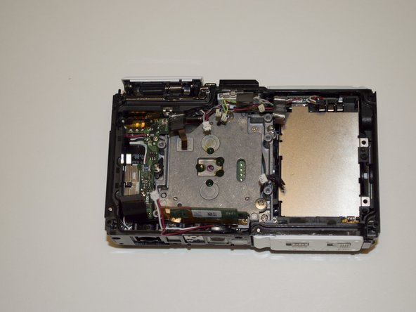

  17. Nikon 1 AW 1 Motherboard Replacement: crwdns2935265:017crwdnd2935265:01crwdnd2935265:03crwdne2935265:0 Nikon 1 AW 1 Motherboard Replacement: crwdns2935265:017crwdnd2935265:02crwdnd2935265:03crwdne2935265:0 Nikon 1 AW 1 Motherboard Replacement: crwdns2935265:017crwdnd2935265:03crwdnd2935265:03crwdne2935265:0
    • Carefully remove the motherboard from the main camera body and replace it for a new one.
