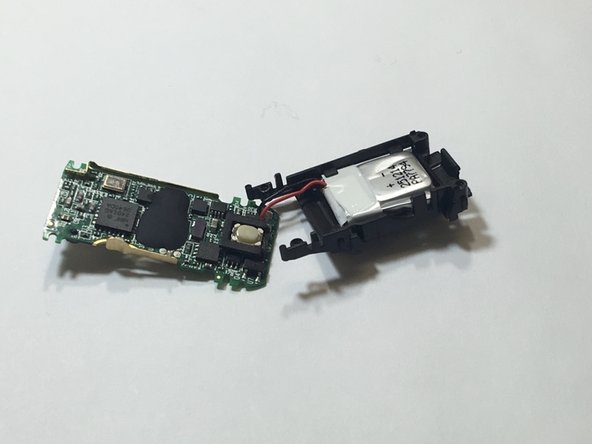

  9. Nike+ Sportband Battery Replacement, Battery: crwdns2935265:09crwdnd2935265:01crwdnd2935265:02crwdne2935265:0 Nike+ Sportband Battery Replacement, Battery: crwdns2935265:09crwdnd2935265:02crwdnd2935265:02crwdne2935265:0
    • Continue lifting the motherboard until the battery and its wires are visible. Tweezers can help lift the board enough to expose the battery area.
  10. Nike+ Sportband Battery Replacement: crwdns2935265:010crwdnd2935265:01crwdnd2935265:01crwdne2935265:0
    • Gently lay the motherboard upside down exposing the underside of the motherboard.
    • The red and black battery wires may need to be desoldered from the board. Check out the How To Solder and Desolder Connections guide for some helpful tips on this.
    • Using the flat edge of a spudger separate the battery from the body of the band.
    • Then replace it with a new battery, which you can get on Amazon (3.7v Li-Pro small battery 50mah).
