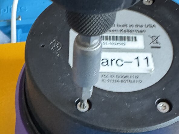

    • Remove the can bumper from the back of the cox box, then remove the four screws.

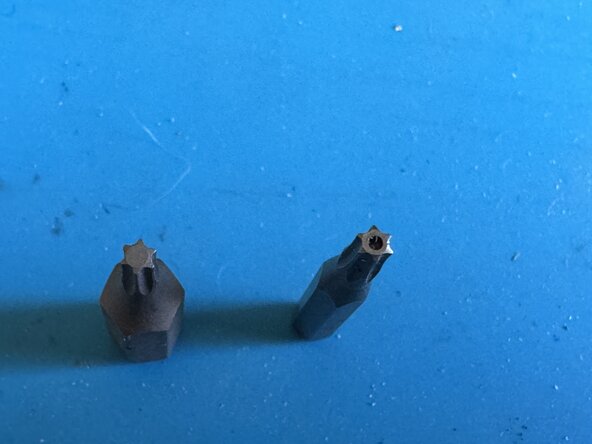

    • Use a Torx T10 bit to remove the screws
  2. Nielsen-Kellerman CoxBox Battery Replacement, Be careful with the screws: crwdns2935265:02crwdnd2935265:01crwdnd2935265:01crwdne2935265:0
    • The outside screws have little orange O-rings on them - do not lose these.
    • Do not overtighten the screws when putting it back together, you do not want to damage the O-rings.

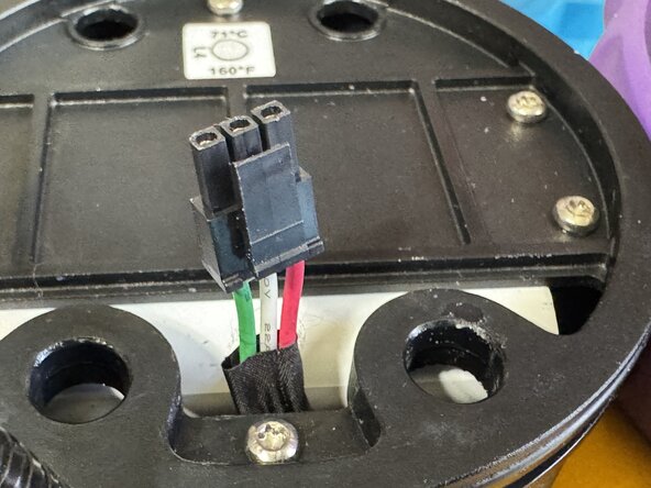

    • Carefully disconnect the battery from the cox box electronics. Do not use excessive force.
    • Note that there is a latch on the back of this connector (the side closest to the edge of the cox box. You MUST press down on the top of the latch before removing the connector.

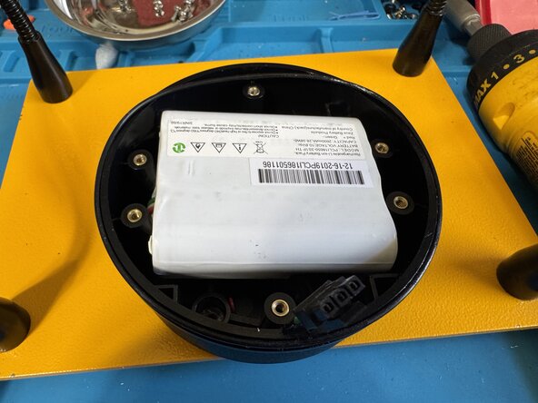

    • Remove the six screws securing the battery in the rear compartment. They use the same T10 Torx bit as the outside screws.
    • Remove the cover of the battery compartment.
    • Lift the old battery out.

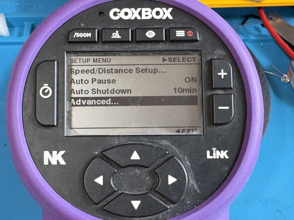

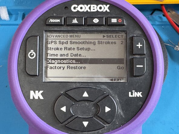

    • You can walk through the diagnostics to see battery voltage and charging information: Main Menu->Setup->Advanced->Diagnostics
