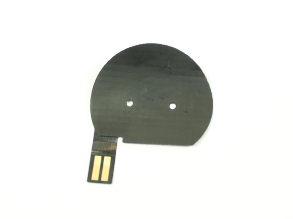

  7. Nexus Q NFC Antenna Replacement, NFC Antenna: crwdns2935265:07crwdnd2935265:01crwdnd2935265:02crwdne2935265:0 Nexus Q NFC Antenna Replacement, NFC Antenna: crwdns2935265:07crwdnd2935265:02crwdnd2935265:02crwdne2935265:0
    • Use a spudger to pry out the NFC antenna.
    • The antenna has two layers; be careful not to pry the two layers apart.
