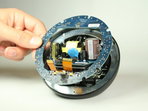

    1. Nexus Q LED Board Replacement, LED Board: crwdns2935265:07crwdnd2935265:01crwdnd2935265:02crwdne2935265:0 Nexus Q LED Board Replacement, LED Board: crwdns2935265:07crwdnd2935265:02crwdnd2935265:02crwdne2935265:0
      • Once you remove the ball bearing ring from the bottom half of the Nexus Q, you will be exposed to a diffuser (white ring) held in with three T6 Torx screws.
      • Use a #0 Philips head screwdriver to remove the three 0.8 mm screws holding the diffuser in place.
    2. Nexus Q LED Board Replacement: crwdns2935265:08crwdnd2935265:01crwdnd2935265:02crwdne2935265:0 Nexus Q LED Board Replacement: crwdns2935265:08crwdnd2935265:02crwdnd2935265:02crwdne2935265:0
      • With the diffuser out, we are exposed to the LED Board.
      • Use a spudger to lightly lift the LED board out.
