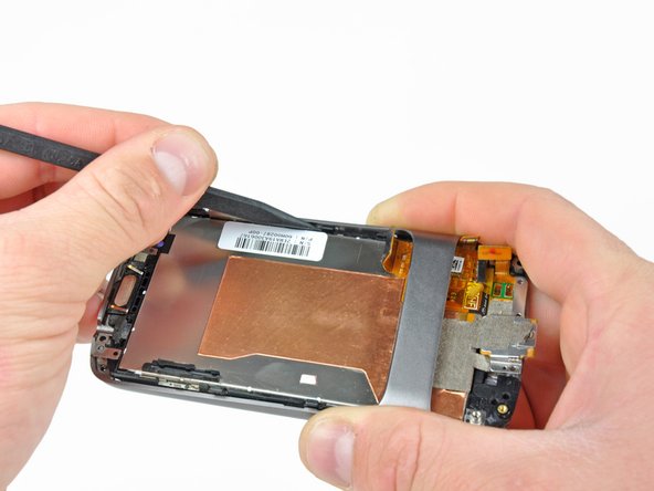

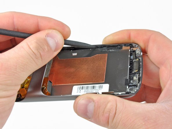

  22. Nexus One Screen Replacement, Screen: crwdns2935265:022crwdnd2935265:01crwdnd2935265:01crwdne2935265:0
    • Remove the seven #00 Philips screws
  23. Nexus One Screen Replacement: crwdns2935265:023crwdnd2935265:01crwdnd2935265:03crwdne2935265:0 Nexus One Screen Replacement: crwdns2935265:023crwdnd2935265:02crwdnd2935265:03crwdne2935265:0 Nexus One Screen Replacement: crwdns2935265:023crwdnd2935265:03crwdnd2935265:03crwdne2935265:0
    • Use the spudger to pop the 3 latches holding the screen down.
  24. Nexus One Screen Replacement: crwdns2935265:024crwdnd2935265:01crwdnd2935265:01crwdne2935265:0
    • Pull up on the screen so it slides out of the case.
    • Make sure to peel off the digitizer connector from the back of the LCD
