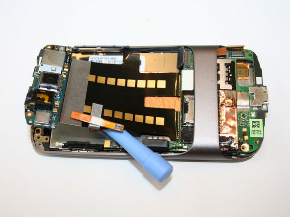

    • Slip out the display+glass compound from the body. seen on the right hand side here, the OLED Display, the Glass and it's frame are still connected.
    • To separate the display, we have to cut the gray fabric in the places indicated

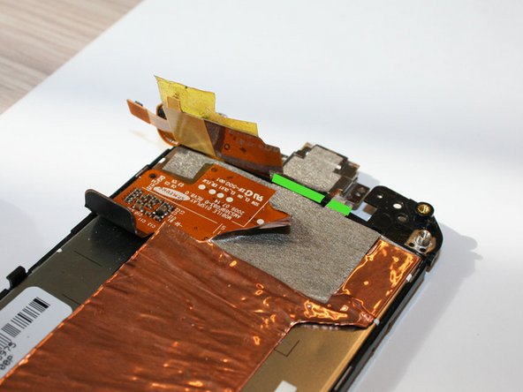

  18. Nexus One Glass Replacement: crwdns2935265:018crwdnd2935265:01crwdnd2935265:02crwdne2935265:0 Nexus One Glass Replacement: crwdns2935265:018crwdnd2935265:02crwdnd2935265:02crwdne2935265:0
    • Unplug the strip (shown in the blue rectangle)
    • Unplug the black cord (shown in the red circle)
    • Unplug three more plugs (not marked)
