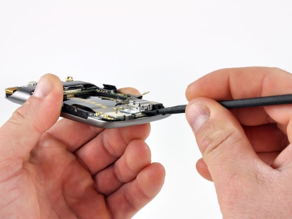

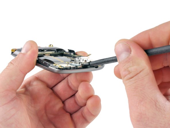

    1. Nexus One Camera Replacement, Camera: crwdns2935265:011crwdnd2935265:01crwdnd2935265:03crwdne2935265:0 Nexus One Camera Replacement, Camera: crwdns2935265:011crwdnd2935265:02crwdnd2935265:03crwdne2935265:0 Nexus One Camera Replacement, Camera: crwdns2935265:011crwdnd2935265:03crwdnd2935265:03crwdne2935265:0
      • Place the spudger under the metal cover and pry upwards. (shoot bottom side first with tabbed clip)
      • Swap the spudger to the other side of the cover base. Pry upwards. (fix?)
      • Grasp the camera module and pull up.
