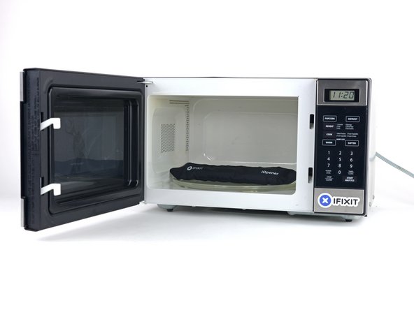

      • We recommend that you clean your microwave before proceeding, as any nasty gunk on the bottom may end up stuck to the iOpener.
      • Place the iOpener in the center of the microwave.
      • For carousel microwaves: Make sure the plate spins freely. If your iOpener gets stuck, it may overheat and burn.
    3. Nexus 9 LCD Screen Replacement: crwdns2935265:024crwdnd2935265:01crwdnd2935265:01crwdne2935265:0
      • Heat the iOpener for thirty seconds.
      • Throughout the repair procedure, as the iOpener cools, reheat it in the microwave for an additional thirty seconds at a time.
      • Be careful not to overheat the iOpener during the repair. Overheating may cause the iOpener to burst.
      • Never touch the iOpener if it appears swollen.
      • Always wait at least three minutes before reheating the iOpener.
