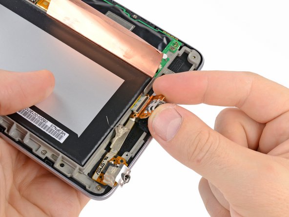

    someone help? my nexus looks completely different
    Music Raider - crwdns2934203:0crwdne2934203:0

  15. Nexus 7 I/O Assembly Cable Replacement: crwdns2935265:015crwdnd2935265:01crwdnd2935265:03crwdne2935265:0 Nexus 7 I/O Assembly Cable Replacement: crwdns2935265:015crwdnd2935265:02crwdnd2935265:03crwdne2935265:0 Nexus 7 I/O Assembly Cable Replacement: crwdns2935265:015crwdnd2935265:03crwdnd2935265:03crwdne2935265:0
    • In a similar fashion, lift the micro-USB port up off its retaining pins.
    • Lift and remove the I/O assembly cable out of the Nexus 7.

* The disconnecting of the I/O Assembly is done just like the battery connection in Step 6. Once you lift the black flap, rock the connection back and forth with the spudger to separate. See the 3rd picture on Step 6 to see what the separated connector looks like.

My N7 had a bad USB connection... It worked fine to charge, but the connection kept dropping randomly when using the USBOTG functions. Pulled the I/O cable out and re-soldered all of the USB socket's pins, works great now.
I had ordered a new socket (Tyco Electronics part 1554266-1, ~$2) in case it needed to be replaced. I didn't end up using it but it looks like it should fit and it has a good solid lock.
