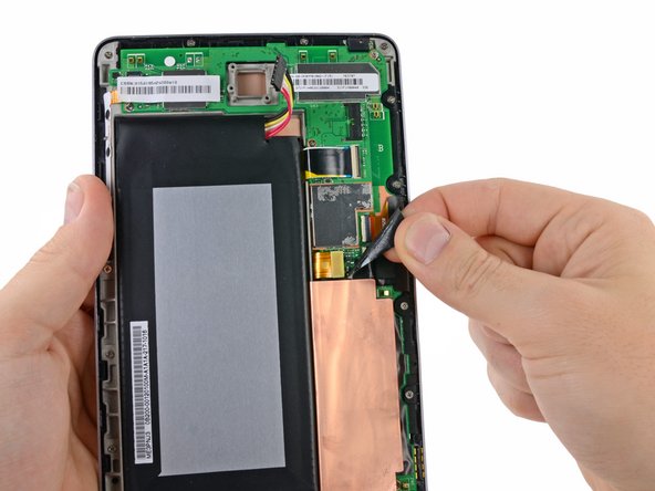

    • Peel the upper piece of black adhesive tape completely up off the Nexus 7.
    • Similarly, peel the lower piece of black adhesive tape, but only as far as the copper strip.
    • It is helpful to fold this piece of tape back on itself to keep it out of the way.
    • Whilst pulling the tape, be sure that the metal shield does not lift up. Hold the shield in place, and if it lifts up, re-seat it in the spring clips around the perimeter of the shielded area.
  8. Nexus 7 Display Assembly Replacement: crwdns2935265:08crwdnd2935265:01crwdnd2935265:01crwdne2935265:0
    • Use the flat end of a spudger to pry the display data cable straight up off its socket on the motherboard.
  9. Nexus 7 Display Assembly Replacement: crwdns2935265:09crwdnd2935265:01crwdnd2935265:03crwdne2935265:0 Nexus 7 Display Assembly Replacement: crwdns2935265:09crwdnd2935265:02crwdnd2935265:03crwdne2935265:0 Nexus 7 Display Assembly Replacement: crwdns2935265:09crwdnd2935265:03crwdnd2935265:03crwdne2935265:0

great but where can i get nexus 7 digitizer, in stock reasonable price in uk please?
Rupert K - crwdns2934203:0crwdne2934203:0
eBay is a good source. I paid £14 for mine and it came with tools.
Robert Leather -
I don't feel that this guide is complete, how do you separate the display from the frame?
Chris - crwdns2934203:0crwdne2934203:0
That's because this guide is for the "Display Assembly". I just tried to remove the LCD itself, extremely difficult. I didn't succeed. Now looking for a whole assembly
Jeremy Cooper -
I've managed to do it using a heat gun. Be careful not to apply to much heat as I warped the frame slightly in one place. Use a prying tool from the top rather than trying to push from the back as the glue is quite tough and peeling it away is easier. You need to reapply heat as you work, it then comes out quite easily. I repurposed the glue strips from the old screen, however taking out bits of glass was a bit tough. The new display fits neatly after that.
