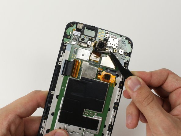

    1. Nexus 6 Motherboard Replacement, Rear Facing Camera: crwdns2935265:06crwdnd2935265:01crwdnd2935265:02crwdne2935265:0 Nexus 6 Motherboard Replacement, Rear Facing Camera: crwdns2935265:06crwdnd2935265:02crwdnd2935265:02crwdne2935265:0
      • Use the spudger to release the rear facing camera connector.
      • Use tweezers to gently remove the rear facing camera.

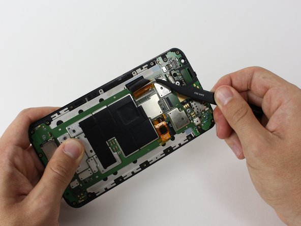

    1. Nexus 6 Motherboard Replacement, Motherboard: crwdns2935265:07crwdnd2935265:01crwdnd2935265:02crwdne2935265:0 Nexus 6 Motherboard Replacement, Motherboard: crwdns2935265:07crwdnd2935265:02crwdnd2935265:02crwdne2935265:0
      • With a spudger, unlatch the ZIF connector for the smallest ribbon cable in the center. See instructions for detatching ZIF connectors here
      • Use tweezers to release the ribbon cable.
