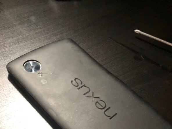

  1. Nexus 5 Antenna Cable Replacement, Remove the Battery Door: crwdns2935265:01crwdnd2935265:01crwdnd2935265:01crwdne2935265:0
    • The battery door of the Nexus 5 is held together with plastic clips.
    • Use the plastic spudger to separate the battery door.
