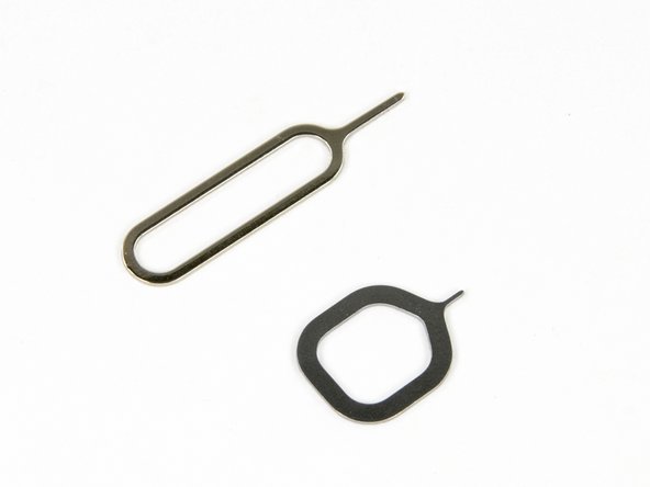

    • Rather than hide the Micro SIM card underneath the battery—a common practice in many phones—LG pushed the Micro SIM slot to the side and included their own stubby SIM eject tool. Very Cupertino.
  6. Nexus 4 Teardown: crwdns2935265:06crwdnd2935265:01crwdnd2935265:02crwdne2935265:0 Nexus 4 Teardown: crwdns2935265:06crwdnd2935265:02crwdnd2935265:02crwdne2935265:0
    • With our newly-acquired SIM card eject tool, we take the first baby step towards dismantling the Nexus 4.
    • Phew, that was exhausting! With the Micro SIM card tray out, the Nexus 4 slims down to a scant 138.8 grams.

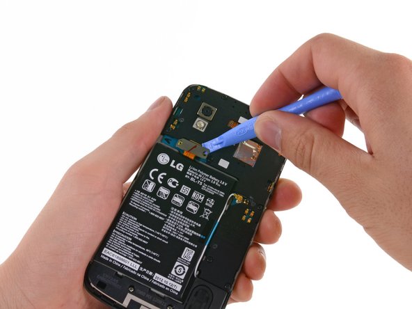

  7. Nexus 4 Teardown: crwdns2935265:07crwdnd2935265:01crwdnd2935265:02crwdne2935265:0 Nexus 4 Teardown: crwdns2935265:07crwdnd2935265:02crwdnd2935265:02crwdne2935265:0
    • After liberating the two T5 Torx screws from their imprisonment, it took a few minutes of diligent work with a plastic opening tool to remove the back cover.
    • It wasn't particularly difficult to open this device, but anyone attempting it without the proper prying tool will face a lot of frustration.
    • Right off the bat we notice that the battery is much harder to replace than in the earlier Galaxy Nexus. This could hurt its repairability score, but it's still early!

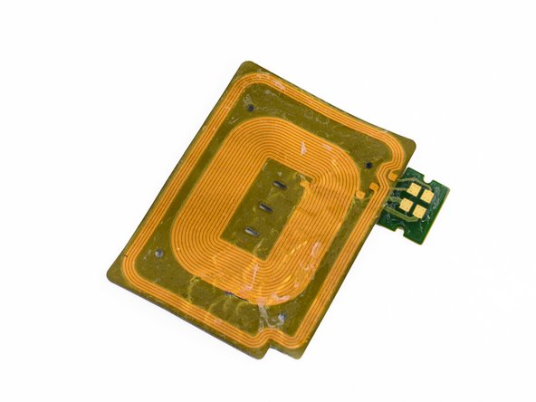

    • The rear cover of most phones is a ho-hum piece of plastic that serves no real purpose other than covering the battery. That is not the case here.
    • A number of pressure contacts power the NFC antenna and connect the induction coil needed for wireless charging to the motherboard.
    • With "wireless charging" listed as an official tech spec for the Nexus 4, we were anxious to try it out on our device. Alas, the phone doesn't ship with a wireless charger. Boo.
    • Two years ago, Google brought NFC to the smartphone realm with the Nexus S. It's been a long road, but the technology seems to finally be catching on.

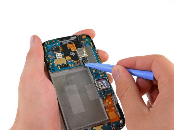

    • Removing the motherboard requires disconnecting a few connectors.
    • Overall, the process was pretty painless and required minimal effort.

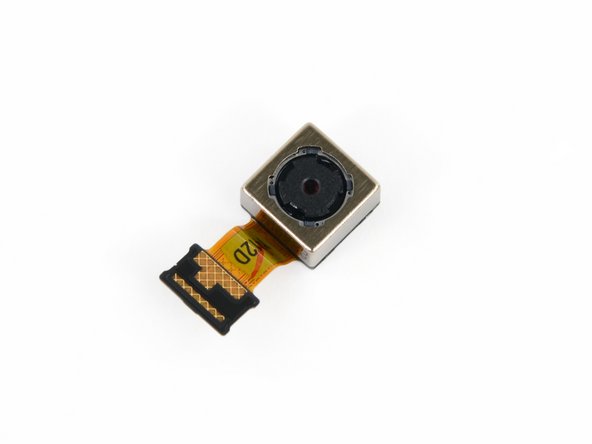

  15. Nexus 4 Teardown: crwdns2935265:015crwdnd2935265:01crwdnd2935265:03crwdne2935265:0 Nexus 4 Teardown: crwdns2935265:015crwdnd2935265:02crwdnd2935265:03crwdne2935265:0 Nexus 4 Teardown: crwdns2935265:015crwdnd2935265:03crwdnd2935265:03crwdne2935265:0

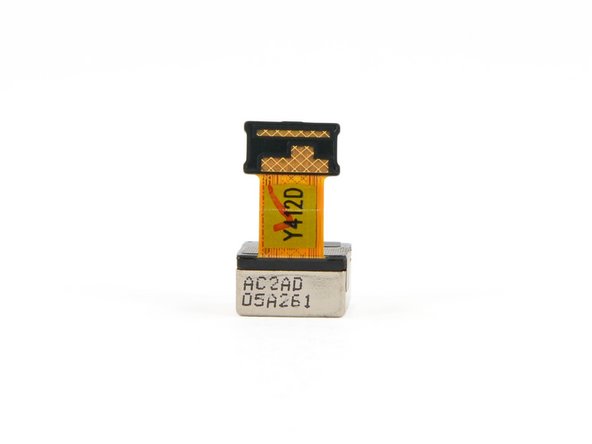

    • Once the motherboard is free, the rear-facing camera is easily removed.
    • The 8 megapixel rear-facing camera is labeled as AC2AD O5A261.

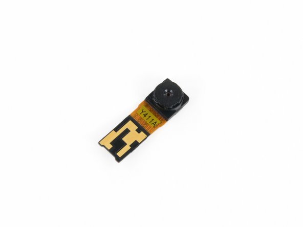

  16. Nexus 4 Teardown: crwdns2935265:016crwdnd2935265:01crwdnd2935265:03crwdne2935265:0 Nexus 4 Teardown: crwdns2935265:016crwdnd2935265:02crwdnd2935265:03crwdne2935265:0 Nexus 4 Teardown: crwdns2935265:016crwdnd2935265:03crwdnd2935265:03crwdne2935265:0
    • The 1.3 megapixel front-facing camera is easily removed.
    • The ribbon cable on the front-facing camera is labeled as Y411A.

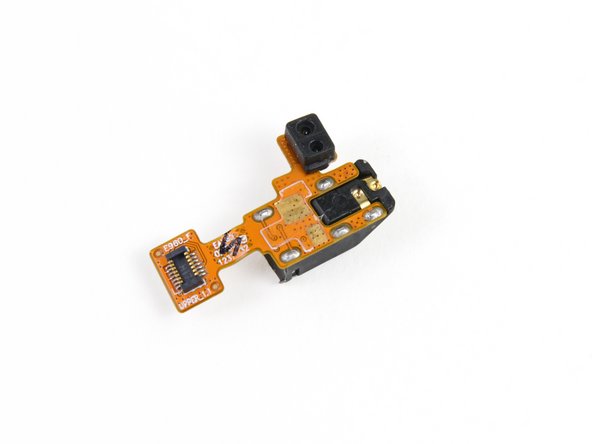

    • Turning our attention back to the front panel, we pull off the standard 3.5 mm headphone jack, which also houses the dual ambient light sensors.

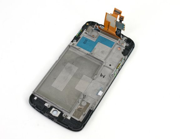

    • Nexus 4 Repairability Score: 7 out of 10 (10 is easiest to repair).
    • Removing the back cover requires nothing more than a common screwdriver, a plastic opening tool, and some patience.
    • The entire device only contains four different length screws—all common screw types—for a total of only 15 screws.
    • Once the back cover and inner frame are removed, pressure contacts make all of the inner components a breeze to replace.
    • The battery is stuck to the frame with a lot of adhesive, so removing it without puncturing the battery can be difficult.
    • The glass is fused to both the display and the display frame. So don't crack the glass unless you're good with a heat gun, or you're fond of replacing the glass, display, and frame together ($$$).
