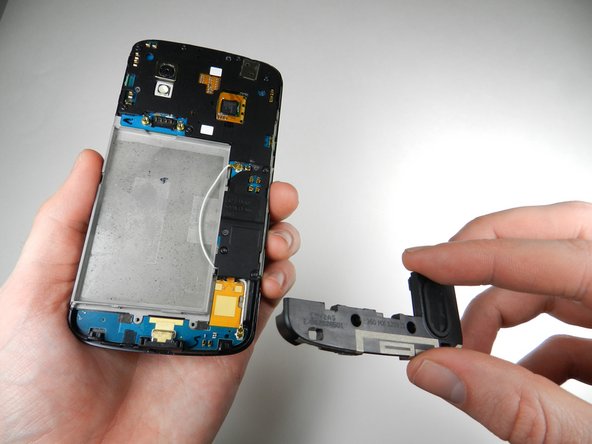

    1. Nexus 4 Motherboard Replacement, Speaker: crwdns2935265:07crwdnd2935265:01crwdnd2935265:02crwdne2935265:0 Nexus 4 Motherboard Replacement, Speaker: crwdns2935265:07crwdnd2935265:02crwdnd2935265:02crwdne2935265:0
      • Remove the two 4.8 mm screws that hold the speaker enclosure together using the Phillips 00 screwdriver.
    2. Nexus 4 Motherboard Replacement: crwdns2935265:08crwdnd2935265:01crwdnd2935265:02crwdne2935265:0 Nexus 4 Motherboard Replacement: crwdns2935265:08crwdnd2935265:02crwdnd2935265:02crwdne2935265:0
      • Gently pry the speaker up and away from the back of the phone using a plastic opening tool, and lift it out of the phone.

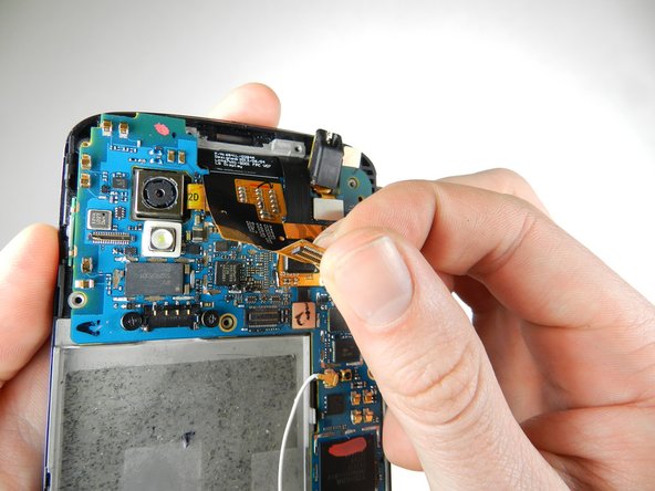

    1. Nexus 4 Motherboard Replacement, Audio Jack: crwdns2935265:09crwdnd2935265:01crwdnd2935265:03crwdne2935265:0 Nexus 4 Motherboard Replacement, Audio Jack: crwdns2935265:09crwdnd2935265:02crwdnd2935265:03crwdne2935265:0 Nexus 4 Motherboard Replacement, Audio Jack: crwdns2935265:09crwdnd2935265:03crwdnd2935265:03crwdne2935265:0
      • Using a spudger, pop off the gray connector on the top right of the motherboard.
    2. Nexus 4 Motherboard Replacement: crwdns2935265:010crwdnd2935265:01crwdnd2935265:03crwdne2935265:0 Nexus 4 Motherboard Replacement: crwdns2935265:010crwdnd2935265:02crwdnd2935265:03crwdne2935265:0 Nexus 4 Motherboard Replacement: crwdns2935265:010crwdnd2935265:03crwdnd2935265:03crwdne2935265:0
      • Gently lift the audio jack upwards and to the left to remove it from the motherboard.
    3. Nexus 4 Motherboard Replacement: crwdns2935265:011crwdnd2935265:01crwdnd2935265:02crwdne2935265:0 Nexus 4 Motherboard Replacement: crwdns2935265:011crwdnd2935265:02crwdnd2935265:02crwdne2935265:0
      • The audio port will likely lift out together with the ambient light sensor rubber cap.
      • Remove the cap from the old part and move it to the new one. Ensure the cap stays in place when installing the new audio port into the phone.

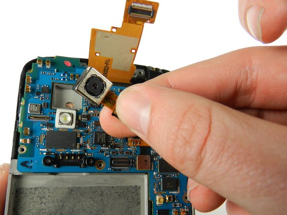

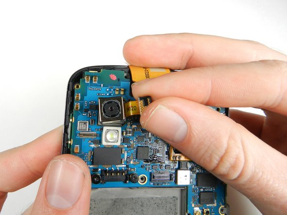

    1. Nexus 4 Motherboard Replacement, Camera: crwdns2935265:012crwdnd2935265:01crwdnd2935265:03crwdne2935265:0 Nexus 4 Motherboard Replacement, Camera: crwdns2935265:012crwdnd2935265:02crwdnd2935265:03crwdne2935265:0 Nexus 4 Motherboard Replacement, Camera: crwdns2935265:012crwdnd2935265:03crwdnd2935265:03crwdne2935265:0
      • Gently pry the metal tab up using a spudger, and lift up the disconnected black flap.
    2. Nexus 4 Motherboard Replacement: crwdns2935265:013crwdnd2935265:01crwdnd2935265:03crwdne2935265:0 Nexus 4 Motherboard Replacement: crwdns2935265:013crwdnd2935265:02crwdnd2935265:03crwdne2935265:0 Nexus 4 Motherboard Replacement: crwdns2935265:013crwdnd2935265:03crwdnd2935265:03crwdne2935265:0
      • With a spudger, carefully pry up the black tab connecting the camera to the motherboard.
      • Lift up the camera from the socket.

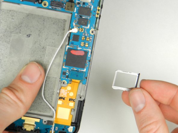

      • Remove the Sim Card and the Sim Card metal tray.
    2. Nexus 4 Motherboard Replacement: crwdns2935265:015crwdnd2935265:01crwdnd2935265:03crwdne2935265:0 Nexus 4 Motherboard Replacement: crwdns2935265:015crwdnd2935265:02crwdnd2935265:03crwdne2935265:0 Nexus 4 Motherboard Replacement: crwdns2935265:015crwdnd2935265:03crwdnd2935265:03crwdne2935265:0

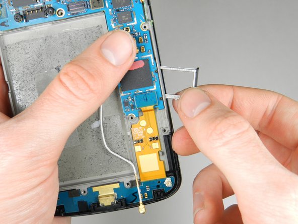

      • Remove the white antenna interconnect cable that attaches the motherboard to the bottom right-hand corner of phone by pulling on it gently.
    3. Nexus 4 Motherboard Replacement: crwdns2935265:016crwdnd2935265:01crwdnd2935265:03crwdne2935265:0 Nexus 4 Motherboard Replacement: crwdns2935265:016crwdnd2935265:02crwdnd2935265:03crwdne2935265:0 Nexus 4 Motherboard Replacement: crwdns2935265:016crwdnd2935265:03crwdnd2935265:03crwdne2935265:0

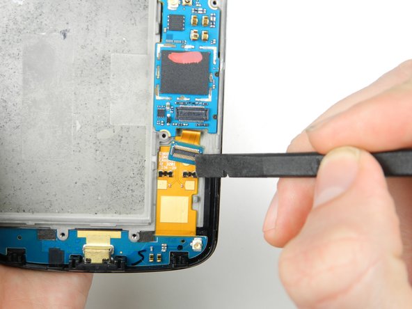

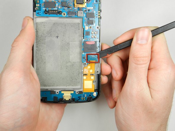

      • Remove the tab located in the bottom right-hand corner of the motherboard attaching the motherboard to the front display assembly using a spudger.
    4. Nexus 4 Motherboard Replacement: crwdns2935265:017crwdnd2935265:01crwdnd2935265:02crwdne2935265:0 Nexus 4 Motherboard Replacement: crwdns2935265:017crwdnd2935265:02crwdnd2935265:02crwdne2935265:0
      • Remove the last tab connecting the motherboard to the front display assembly located in the upper right-hand corner of the motherboard using a spudger.
      • Once this tab is removed, the flap will be free and will spring away from the motherboard.

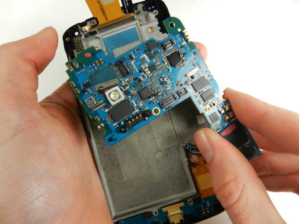

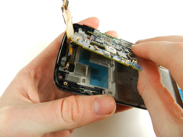

    5. Nexus 4 Motherboard Replacement: crwdns2935265:018crwdnd2935265:01crwdnd2935265:03crwdne2935265:0 Nexus 4 Motherboard Replacement: crwdns2935265:018crwdnd2935265:02crwdnd2935265:03crwdne2935265:0 Nexus 4 Motherboard Replacement: crwdns2935265:018crwdnd2935265:03crwdnd2935265:03crwdne2935265:0
      • Using a spudger, gently lift up the motherboard from the front display assembly.
      • Carefully remove the motherboard using your hands.
