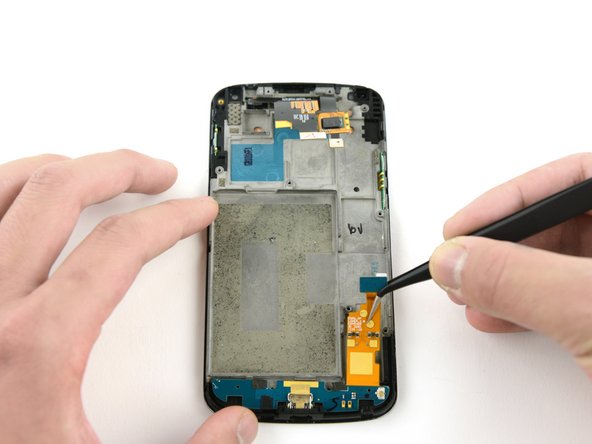

  19. Nexus 4 Display Assembly Replacement, Display Assembly: crwdns2935265:019crwdnd2935265:01crwdnd2935265:03crwdne2935265:0 Nexus 4 Display Assembly Replacement, Display Assembly: crwdns2935265:019crwdnd2935265:02crwdnd2935265:03crwdne2935265:0 Nexus 4 Display Assembly Replacement, Display Assembly: crwdns2935265:019crwdnd2935265:03crwdnd2935265:03crwdne2935265:0
    • Grasp the daughterboard with tweezers.
    • Gently pull upwards to slide the connector out of the charging port housing.
    • Remove the daughterboard from the display assembly.
  20. Nexus 4 Display Assembly Replacement: crwdns2935265:020crwdnd2935265:01crwdnd2935265:01crwdne2935265:0
    • Remove the power and volume button switches from the display assembly.
    • Compare your old display assembly to your replacement part and verify that they match. If there are any small components missing from the replacement display, transfer them over from you old display.
