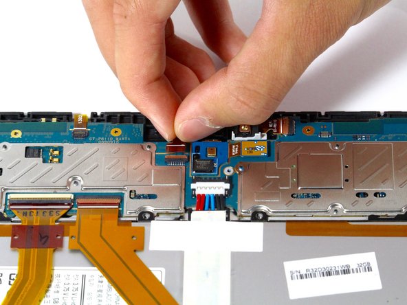

  3. Nexus 10 Front Facing Camera Replacement: crwdns2935265:03crwdnd2935265:01crwdnd2935265:03crwdne2935265:0 Nexus 10 Front Facing Camera Replacement: crwdns2935265:03crwdnd2935265:02crwdnd2935265:03crwdne2935265:0 Nexus 10 Front Facing Camera Replacement: crwdns2935265:03crwdnd2935265:03crwdnd2935265:03crwdne2935265:0
    • Lift latch on front-facing camera connector.
    • Pull the connector toward the top of the device and remove the front-facing camera.
