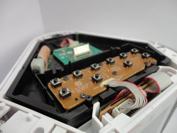

      • Unscrew the two screws with a Phillips #0 screwdriver on the top side of the device right in front of the eight buttons.
    2. Nextplay NP109CR Disassembly: crwdns2935265:02crwdnd2935265:01crwdnd2935265:01crwdne2935265:0
      • Remove the lid from the device.
    3. Nextplay NP109CR Disassembly: crwdns2935265:03crwdnd2935265:01crwdnd2935265:01crwdne2935265:0
      • Unscrew the four screws with a Phillips #0 Screwdriver from the pink button sheet.
    4. Nextplay NP109CR Disassembly: crwdns2935265:04crwdnd2935265:01crwdnd2935265:02crwdne2935265:0 Nextplay NP109CR Disassembly: crwdns2935265:04crwdnd2935265:02crwdnd2935265:02crwdne2935265:0
      • Remove the pink button sheet from the device by pulling out each button.
Reverse these steps to reassemble the device.
