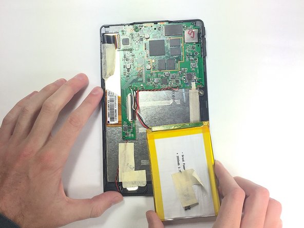

  3. Nextbook Premium 7SE Volume Buttons Replacement, Battery: crwdns2935265:03crwdnd2935265:01crwdnd2935265:01crwdne2935265:0
    • Remove masking tape from the battery.
  4. Nextbook Premium 7SE Volume Buttons Replacement: crwdns2935265:04crwdnd2935265:01crwdnd2935265:03crwdne2935265:0 Nextbook Premium 7SE Volume Buttons Replacement: crwdns2935265:04crwdnd2935265:02crwdnd2935265:03crwdne2935265:0 Nextbook Premium 7SE Volume Buttons Replacement: crwdns2935265:04crwdnd2935265:03crwdnd2935265:03crwdne2935265:0
    • Pry the battery from the base using the nylon spudger and move it away from the motherboard.
    • Handle the battery with care to avoid damaging it.
  5. Nextbook Premium 7SE Volume Buttons Replacement: crwdns2935265:05crwdnd2935265:01crwdnd2935265:03crwdne2935265:0 Nextbook Premium 7SE Volume Buttons Replacement: crwdns2935265:05crwdnd2935265:02crwdnd2935265:03crwdne2935265:0 Nextbook Premium 7SE Volume Buttons Replacement: crwdns2935265:05crwdnd2935265:03crwdnd2935265:03crwdne2935265:0
    • De-solder the three contact points and remove the battery.
    • See the following guide for instructions on how to solder. How To Solder and Desolder Connections
    • Use caution when operating the soldering iron.

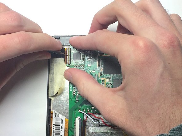

    • Remove the two ZIF connectors attached to the motherboard by flipping up the black tabs before pulling the ribbon cable away.
    • Only use a fingernail or nylon spudger to flip up the retaining flap. Using metal tools may damage delicate components.
