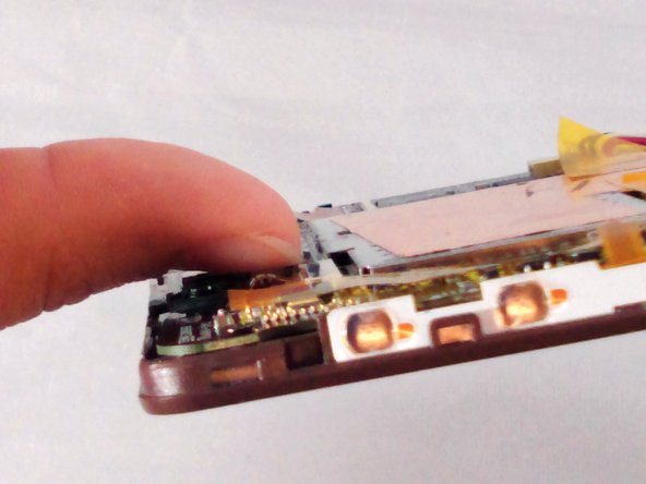

    • •With the tip of the thin metal spudger in place, use a prying motion to work the spudger down the side to the corner of the device.
  2. Nextbook NXA8QC116B Front Camera Replacement: crwdns2935265:02crwdnd2935265:01crwdnd2935265:02crwdne2935265:0 Nextbook NXA8QC116B Front Camera Replacement: crwdns2935265:02crwdnd2935265:02crwdnd2935265:02crwdne2935265:0
    • Continue working the spudger downward and pry with the spudger until the bottom left-hand corner of the tablet is reached.

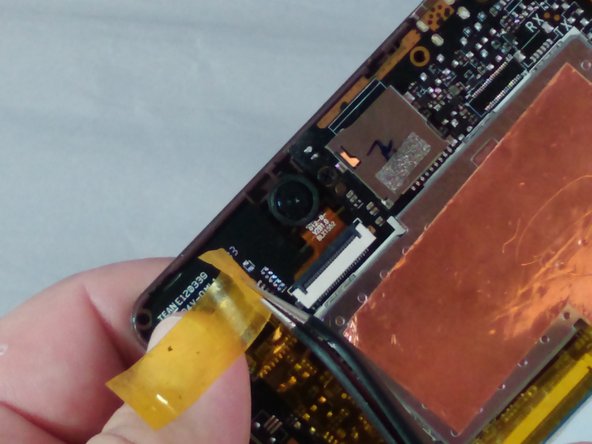

  17. Nextbook NXA8QC116B Front Camera Replacement, Front Camera: crwdns2935265:017crwdnd2935265:01crwdnd2935265:01crwdne2935265:0
    • Locate the front camera on the upper left-hand corner
  18. Nextbook NXA8QC116B Front Camera Replacement: crwdns2935265:018crwdnd2935265:01crwdnd2935265:02crwdne2935265:0 Nextbook NXA8QC116B Front Camera Replacement: crwdns2935265:018crwdnd2935265:02crwdnd2935265:02crwdne2935265:0
    • Remove the yellow cellophane tape with the tweezers from the ZIF connector.
  19. Nextbook NXA8QC116B Front Camera Replacement: crwdns2935265:019crwdnd2935265:01crwdnd2935265:02crwdne2935265:0 Nextbook NXA8QC116B Front Camera Replacement: crwdns2935265:019crwdnd2935265:02crwdnd2935265:02crwdne2935265:0
    • Using your fingernail, flip up the ZIF connector retainer. If you do not have fingernails long enough, use the black plastic spudger.

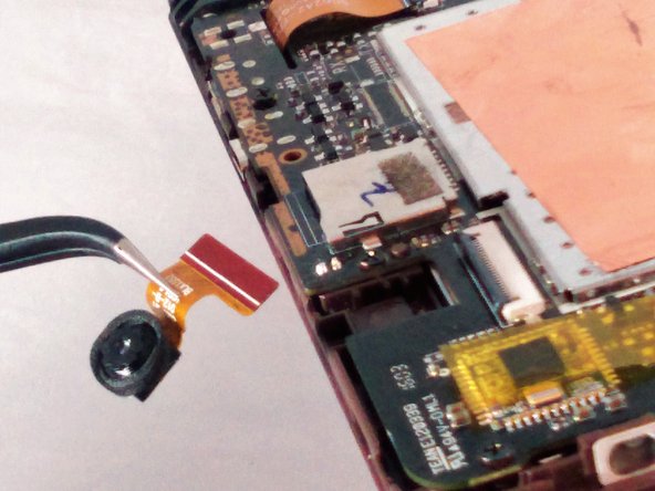

  20. Nextbook NXA8QC116B Front Camera Replacement: crwdns2935265:020crwdnd2935265:01crwdnd2935265:02crwdne2935265:0 Nextbook NXA8QC116B Front Camera Replacement: crwdns2935265:020crwdnd2935265:02crwdnd2935265:02crwdne2935265:0
    • Be careful when removing the camera. The underside of the camera head has adhesive and may be adhered to the tablet. If this happens, use the black plastic spudger to carefully pry up on the underside of the camera head to loosen it from the tablet before pulling on the ribbon cable with the tweezers.
    • Use tweezers to remove the front camera by pulling.
