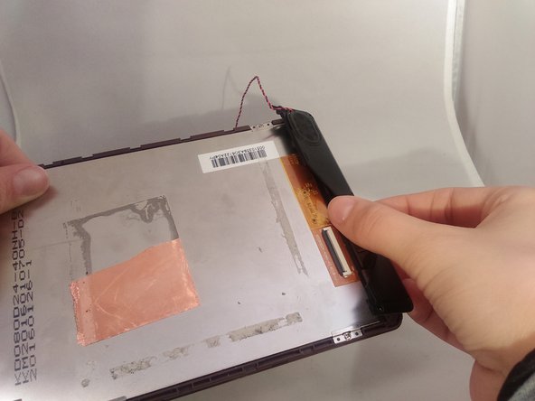

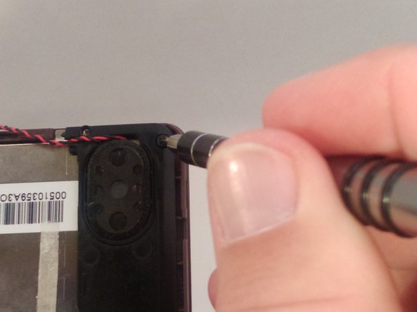

  30. Nextbook NXA8QC116B Display Assembly Replacement, Display Assembly: crwdns2935265:030crwdnd2935265:01crwdnd2935265:03crwdne2935265:0 Nextbook NXA8QC116B Display Assembly Replacement, Display Assembly: crwdns2935265:030crwdnd2935265:02crwdnd2935265:03crwdne2935265:0 Nextbook NXA8QC116B Display Assembly Replacement, Display Assembly: crwdns2935265:030crwdnd2935265:03crwdnd2935265:03crwdne2935265:0
    • Locate and remove the 3 black 4.0 mm screws on the speaker panel using a J00 screwdriver.
    • Disconnect the speaker from the motherboard.
    • Remove the panel.
  31. Nextbook NXA8QC116B Display Assembly Replacement: crwdns2935265:031crwdnd2935265:01crwdnd2935265:01crwdne2935265:0
    • Display Assembly
Robert Englehardt
