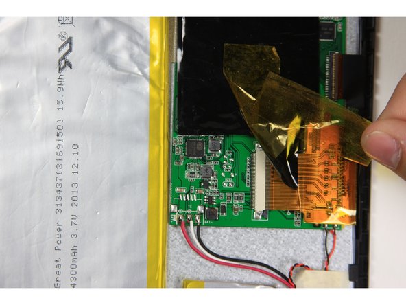

  6. Nextbook NX008HD8G Speaker Replacement, Speaker: crwdns2935265:06crwdnd2935265:01crwdnd2935265:03crwdne2935265:0 Nextbook NX008HD8G Speaker Replacement, Speaker: crwdns2935265:06crwdnd2935265:02crwdnd2935265:03crwdne2935265:0 Nextbook NX008HD8G Speaker Replacement, Speaker: crwdns2935265:06crwdnd2935265:03crwdnd2935265:03crwdne2935265:0
    • Remove yellow tape with a black edge that covers the red, white and black wires.
    • The yellow tape with a black edge is safe to remove completely.
  7. Nextbook NX008HD8G Speaker Replacement: crwdns2935265:07crwdnd2935265:01crwdnd2935265:03crwdne2935265:0 Nextbook NX008HD8G Speaker Replacement: crwdns2935265:07crwdnd2935265:02crwdnd2935265:03crwdne2935265:0 Nextbook NX008HD8G Speaker Replacement: crwdns2935265:07crwdnd2935265:03crwdnd2935265:03crwdne2935265:0
    • Using the sharp end of the spudger, release the black latches on both sides of the white ribbon connector by pushing them to the right (out away from the center of the device).
    • Using your finger, disconnect the gold ribbon from the white ribbon connector.

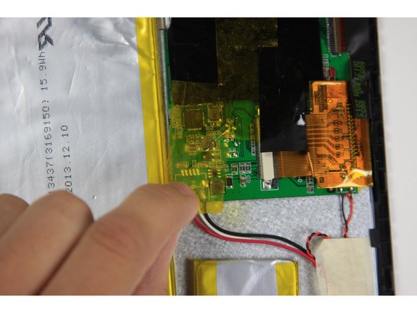

  8. Nextbook NX008HD8G Speaker Replacement: crwdns2935265:08crwdnd2935265:01crwdnd2935265:01crwdne2935265:0
    • Remove the masking tape covering black and red wires that connect the speaker to the right side of the bottom of the motherboard.
  9. Nextbook NX008HD8G Speaker Replacement: crwdns2935265:09crwdnd2935265:01crwdnd2935265:01crwdne2935265:0
    • Desolder the red and black wires on the right side of the motherboard that connect the speaker to the motherboard.

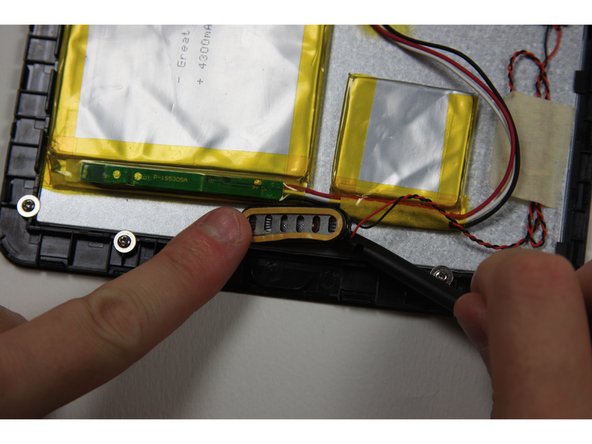

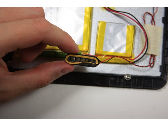

  10. Nextbook NX008HD8G Speaker Replacement: crwdns2935265:010crwdnd2935265:01crwdnd2935265:03crwdne2935265:0 Nextbook NX008HD8G Speaker Replacement: crwdns2935265:010crwdnd2935265:02crwdnd2935265:03crwdne2935265:0 Nextbook NX008HD8G Speaker Replacement: crwdns2935265:010crwdnd2935265:03crwdnd2935265:03crwdne2935265:0
    • Using the flat end of the spudger, remove the speaker from the device by sliding the spudger underneath the speaker.
