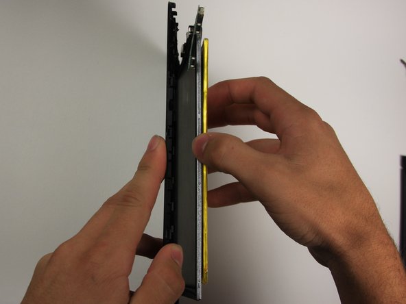

  5. Nextbook NX008HD8G Screen Replacement: crwdns2935265:05crwdnd2935265:01crwdnd2935265:02crwdne2935265:0 Nextbook NX008HD8G Screen Replacement: crwdns2935265:05crwdnd2935265:02crwdnd2935265:02crwdne2935265:0
    • Use your hands to completely separate the rest of the front glass from the back panel.
    • Do not to pull the device apart with too much force. If you do, you may break or bend the back panel.

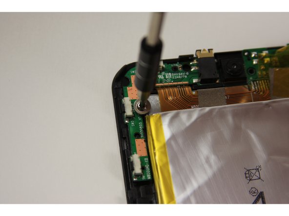

    • Using the Phillips #0 bit with the iFixit screwdriver, remove the four 5 mm screws with the washers around them connecting the digitizer to the screen.

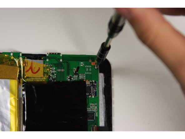

    • Using the Phillips #0 bit with the iFixit screwdriver, remove the two 5 mm screws connecting the motherboard to the back of the digitizer.

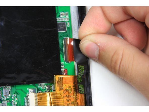

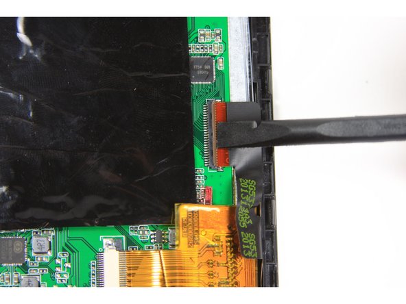

    • Using the flat end of the plastic spudger, open the black ribbon connector door on the right side of the motherboard.
    • Pull the ribbon out of the ribbon connector using your finger.

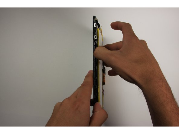

    • To separate the digitizer from the screen, tilt the device on its right side and use your other hand to pull the battery to the right.
    • If you tilt the device too far the digitizer may fall out.
    • The upper left corner of the motherboard may be harder to disconnect from the screen.
