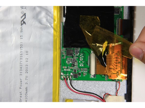

  6. Nextbook NX008HD8G Battery Replacement, Battery: crwdns2935265:06crwdnd2935265:01crwdnd2935265:03crwdne2935265:0 Nextbook NX008HD8G Battery Replacement, Battery: crwdns2935265:06crwdnd2935265:02crwdnd2935265:03crwdne2935265:0 Nextbook NX008HD8G Battery Replacement, Battery: crwdns2935265:06crwdnd2935265:03crwdnd2935265:03crwdne2935265:0
    • Remove yellow tape with a black edge that covers the red, white and black wires.
    • The yellow tape with a black edge is safe to remove completely.

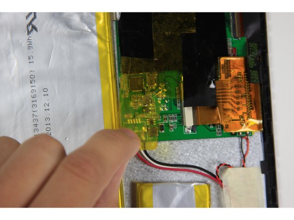

  7. Nextbook NX008HD8G Battery Replacement: crwdns2935265:07crwdnd2935265:01crwdnd2935265:01crwdne2935265:0
    • Remove the white masking tape covering the red white and black wires.

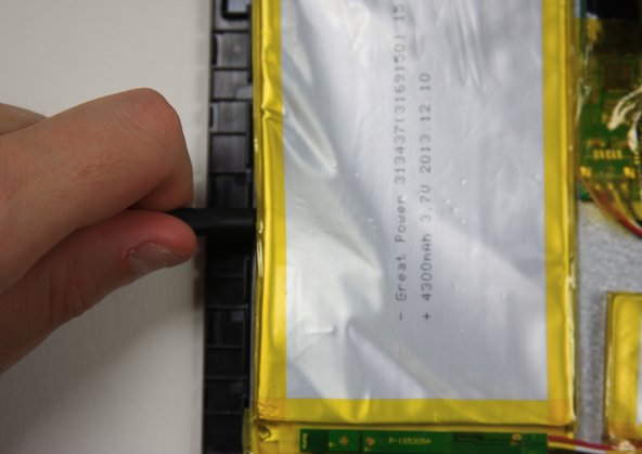

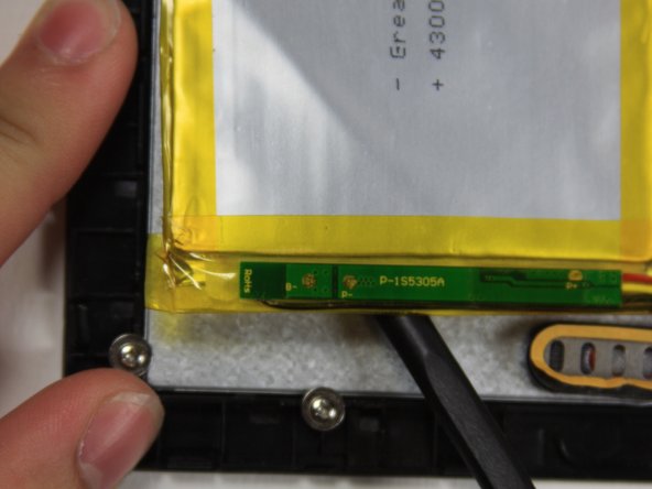

    • Use the flat end of the spudger to carefully separate the smaller, silver battery square from the digitizer.
    • The battery is very malleable, do not try to take it all off at once.
  10. Nextbook NX008HD8G Battery Replacement: crwdns2935265:010crwdnd2935265:01crwdnd2935265:03crwdne2935265:0 Nextbook NX008HD8G Battery Replacement: crwdns2935265:010crwdnd2935265:02crwdnd2935265:03crwdne2935265:0 Nextbook NX008HD8G Battery Replacement: crwdns2935265:010crwdnd2935265:03crwdnd2935265:03crwdne2935265:0
    • Use the flat end of the spudger to carefully separate the large battery from the digitizer.
