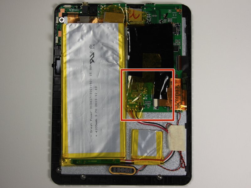

    1. Nextbook NX008HD8G Battery Replacement, Battery: crwdns2935265:06crwdnd2935265:01crwdnd2935265:03crwdne2935265:0 Nextbook NX008HD8G Battery Replacement, Battery: crwdns2935265:06crwdnd2935265:02crwdnd2935265:03crwdne2935265:0 Nextbook NX008HD8G Battery Replacement, Battery: crwdns2935265:06crwdnd2935265:03crwdnd2935265:03crwdne2935265:0
      • Remove yellow tape with a black edge that covers the red, white and black wires.
      • The yellow tape with a black edge is safe to remove completely.
