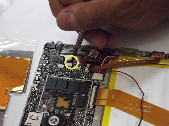

  4. Nextbook Flexx 10 Speaker Replacement, Speakers: crwdns2935265:04crwdnd2935265:01crwdnd2935265:01crwdne2935265:0
    • See the first image to see the position of the speakers and their connections.
  5. Nextbook Flexx 10 Speaker Replacement: crwdns2935265:05crwdnd2935265:01crwdnd2935265:03crwdne2935265:0 Nextbook Flexx 10 Speaker Replacement: crwdns2935265:05crwdnd2935265:02crwdnd2935265:03crwdne2935265:0 Nextbook Flexx 10 Speaker Replacement: crwdns2935265:05crwdnd2935265:03crwdnd2935265:03crwdne2935265:0
    • To remove the speaker shown in the picture:
    • Remove both screws with a small Philips head screwdriver.
    • Look at how the connector sits, and how the wires are routed. You will need to put these back in the same orientation during reassembly.
    • Gently remove connector and replace assembly if needed.

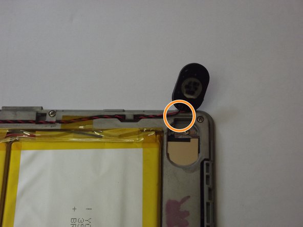

  6. Nextbook Flexx 10 Speaker Replacement: crwdns2935265:06crwdnd2935265:01crwdnd2935265:03crwdne2935265:0 Nextbook Flexx 10 Speaker Replacement: crwdns2935265:06crwdnd2935265:02crwdnd2935265:03crwdne2935265:0 Nextbook Flexx 10 Speaker Replacement: crwdns2935265:06crwdnd2935265:03crwdnd2935265:03crwdne2935265:0
    • Gently pry speaker free.
    • Carefully pull cable free to connector.
    • Gently remove connector.
