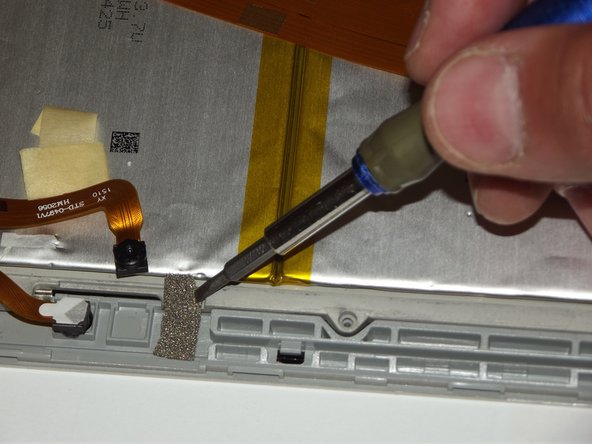

    • 2 - Remove tape and gently pry up cameras. These are held on with an adhesive.
    • 3 - Lift up tape. Gently lift up black tab and remove the ribbon cable that leads to the buttons.
    • 4 - Gently lift away tape and remove speaker connector. Best to use a back and forth motion while gently pulling, or separate black from white with a flat screwdriver.
    • 5 - Gently lift black tab and remove cable. This ribbon cable leads to the screen.
    • 6 - You will need to carefully free one side of the silver foam that is under the tape by the cameras. This is shown in the second picture.

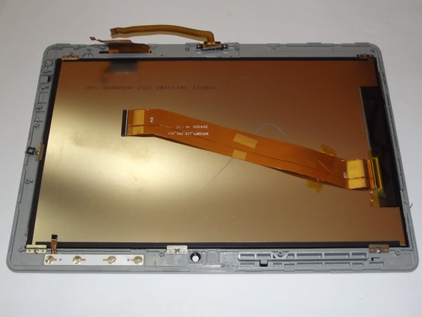

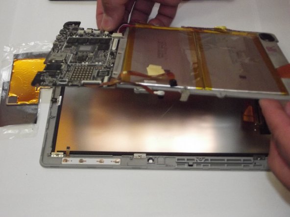

  6. Nextbook Flexx 10 Screen or Digitizer Replacement: crwdns2935265:06crwdnd2935265:01crwdnd2935265:03crwdne2935265:0 Nextbook Flexx 10 Screen or Digitizer Replacement: crwdns2935265:06crwdnd2935265:02crwdnd2935265:03crwdne2935265:0 Nextbook Flexx 10 Screen or Digitizer Replacement: crwdns2935265:06crwdnd2935265:03crwdnd2935265:03crwdne2935265:0
    • Once you have removed all of the screws and unhooked all of the cables, gently lift the board assembly away from the screen assemble, freeing any components that may get caught up. Ribbon cables frequently catch.
    • (We have removed some things that you do not need to in the second picture, so please disregard these. If you have followed the instructions so far, you should be fine.)
    • When the board assembly is removed, you should see what is shown in the third picture.

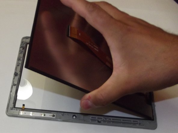

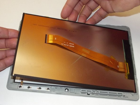

  8. Nextbook Flexx 10 Screen or Digitizer Replacement: crwdns2935265:08crwdnd2935265:01crwdnd2935265:03crwdne2935265:0 Nextbook Flexx 10 Screen or Digitizer Replacement: crwdns2935265:08crwdnd2935265:02crwdnd2935265:03crwdne2935265:0 Nextbook Flexx 10 Screen or Digitizer Replacement: crwdns2935265:08crwdnd2935265:03crwdnd2935265:03crwdne2935265:0
    • CAREFULLY separate the screen from the digitizer using uniformly distributed gentle force. Using too much force will break these objects!
    • Take your time with this step!

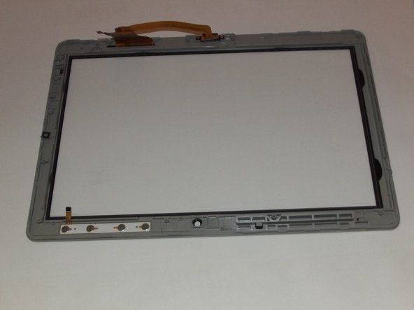

  9. Nextbook Flexx 10 Screen or Digitizer Replacement: crwdns2935265:09crwdnd2935265:01crwdnd2935265:02crwdne2935265:0 Nextbook Flexx 10 Screen or Digitizer Replacement: crwdns2935265:09crwdnd2935265:02crwdnd2935265:02crwdne2935265:0
    • The black unit is the screen, and the clear unit is the digitizer. Replace whichever you need to, then reassemble.
