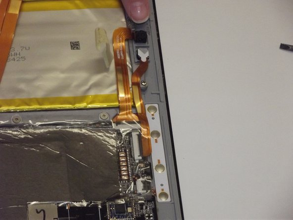

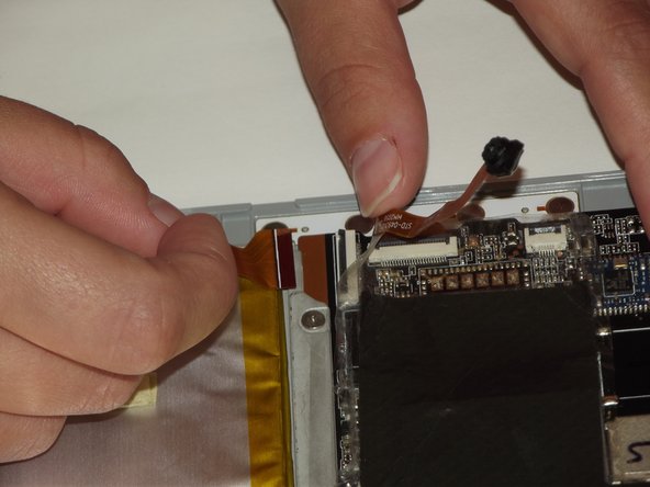

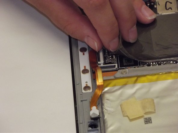

  4. Nextbook Flexx 10 Camera Replacement: crwdns2935265:04crwdnd2935265:01crwdnd2935265:03crwdne2935265:0 Nextbook Flexx 10 Camera Replacement: crwdns2935265:04crwdnd2935265:02crwdnd2935265:03crwdne2935265:0 Nextbook Flexx 10 Camera Replacement: crwdns2935265:04crwdnd2935265:03crwdnd2935265:03crwdne2935265:0
    • Find the front camera.
    • Follow the gold strip to where it connects to the device.
    • There is a black piece that is holding the gold strip. Flip this up to release the camera.
    • Follow bullets above for the rear facing camera.
