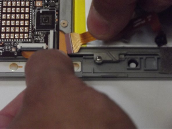

    • Remove the smaller ribbon clip on the right side of the device and the top right of the battery.
    • Remove the second clip underneath the ribbon clip.
  6. Nextbook Flexx 10 Battery Pack Replacement: crwdns2935265:06crwdnd2935265:01crwdnd2935265:03crwdne2935265:0 Nextbook Flexx 10 Battery Pack Replacement: crwdns2935265:06crwdnd2935265:02crwdnd2935265:03crwdne2935265:0 Nextbook Flexx 10 Battery Pack Replacement: crwdns2935265:06crwdnd2935265:03crwdnd2935265:03crwdne2935265:0

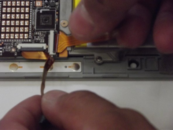

    • When removing the second cable clip, use a small flat-head screwdriver to lift the latch.
    • When removing, be careful not to damage the ribbon cable.
  7. Nextbook Flexx 10 Battery Pack Replacement: crwdns2935265:07crwdnd2935265:01crwdnd2935265:02crwdne2935265:0 Nextbook Flexx 10 Battery Pack Replacement: crwdns2935265:07crwdnd2935265:02crwdnd2935265:02crwdne2935265:0
    • Repeat Step 6 for the large ribbon cable.
