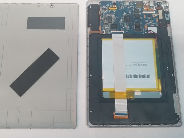

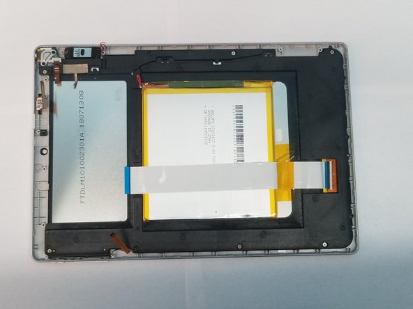

  1. Nextbook Ares 10A Digitizer Replacement, Removing the back cover: crwdns2935265:01crwdnd2935265:01crwdnd2935265:02crwdne2935265:0 Nextbook Ares 10A Digitizer Replacement, Removing the back cover: crwdns2935265:01crwdnd2935265:02crwdnd2935265:02crwdne2935265:0
    • There are several retaining clips holding the back cover on the device.
    • Use a pry tool to seperate the back cover from the device.

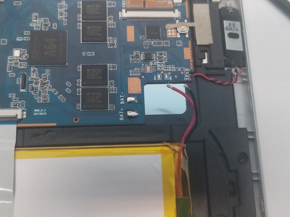

  2. Nextbook Ares 10A Digitizer Replacement, Desoldering the battery: crwdns2935265:02crwdnd2935265:01crwdnd2935265:02crwdne2935265:0 Nextbook Ares 10A Digitizer Replacement, Desoldering the battery: crwdns2935265:02crwdnd2935265:02crwdnd2935265:02crwdne2935265:0
    • The battery is connected to the motherboard. We must disconnect it first before proceeding.
    • To disconnect the battery we must use a "soldering iron'' to disconnect the leads to the motherboard
    • Be very careful not to short the battery wires.
    • With the battery successfully disconnected we can move on with the repair while also keeping us and the device safe
    • It's a good idea to put tape over the ends of the battery lead to protect it from touching anything.

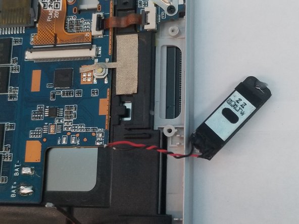

  3. Nextbook Ares 10A Digitizer Replacement, Removing the speaker: crwdns2935265:03crwdnd2935265:01crwdnd2935265:02crwdne2935265:0 Nextbook Ares 10A Digitizer Replacement, Removing the speaker: crwdns2935265:03crwdnd2935265:02crwdnd2935265:02crwdne2935265:0
    • It may be a good idea to lift out the speaker at this point so the cables dont tear.
    • You will be moving the speaker over to the new digitizer and frame combo.

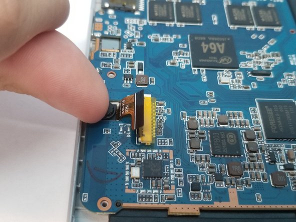

  4. Nextbook Ares 10A Digitizer Replacement, Disconnecting the ribbon cables: crwdns2935265:04crwdnd2935265:01crwdnd2935265:01crwdne2935265:0
    • Flip up the five retaining flaps and pull out the fragile cables for the power and volume button, lcd, camera, digitizer, and daughter board holding the headphone jack.
    • It is not necessary to disconnect the camera but not doing so can risk tearing the fragile cable while removing the motherboard

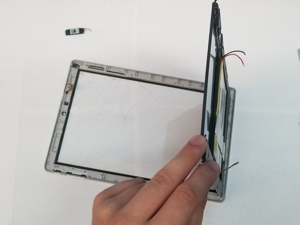

  7. Nextbook Ares 10A Digitizer Replacement, Removing the lcd: crwdns2935265:07crwdnd2935265:01crwdnd2935265:02crwdne2935265:0 Nextbook Ares 10A Digitizer Replacement, Removing the lcd: crwdns2935265:07crwdnd2935265:02crwdnd2935265:02crwdne2935265:0
    • Remove the silver plate over the headphone jack and lift up on the headphone jack to remove it.
    • At this point, the lcd can be removed, the battery, power and volume control are both glued onto the assembly.
    • While lifting the lcd assembly out, ensure that you do not touch the screen on the other side and that the power controller stays attached to it.

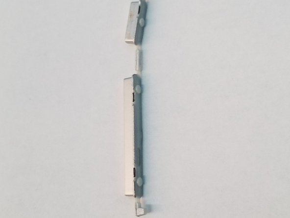

  8. Nextbook Ares 10A Digitizer Replacement, Removing the power buttons: crwdns2935265:08crwdnd2935265:01crwdnd2935265:02crwdne2935265:0 Nextbook Ares 10A Digitizer Replacement, Removing the power buttons: crwdns2935265:08crwdnd2935265:02crwdnd2935265:02crwdne2935265:0
    • Lastly, the power and volume buttons need to be moved over to the new digitizer frame
