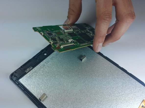

  8. Nextbook 8 Screen Replacement: crwdns2935265:08crwdnd2935265:01crwdnd2935265:02crwdne2935265:0 Nextbook 8 Screen Replacement: crwdns2935265:08crwdnd2935265:02crwdnd2935265:02crwdne2935265:0
    • Remove the 5 black screws on the motherboard.
    • Carefully lift the motherboard off of the device and remove.
