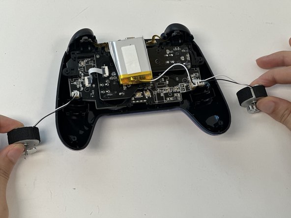

  4. NexiGo NS32 Vibration Motor Replacement, Vibration Motor: crwdns2935265:04crwdnd2935265:01crwdnd2935265:03crwdne2935265:0 NexiGo NS32 Vibration Motor Replacement, Vibration Motor: crwdns2935265:04crwdnd2935265:02crwdnd2935265:03crwdne2935265:0 NexiGo NS32 Vibration Motor Replacement, Vibration Motor: crwdns2935265:04crwdnd2935265:03crwdnd2935265:03crwdne2935265:0
    • Grip the white vibration motor connections and pull them directly out of their sockets.
  5. NexiGo NS32 Vibration Motor Replacement: crwdns2935265:05crwdnd2935265:01crwdnd2935265:02crwdne2935265:0 NexiGo NS32 Vibration Motor Replacement: crwdns2935265:05crwdnd2935265:02crwdnd2935265:02crwdne2935265:0
    • Gently lift out the vibration motors.
    • The vibration motors may be glued in place. If you're having trouble removing them, apply some high-concentration isopropyl alcohol to loosen the adhesive.
