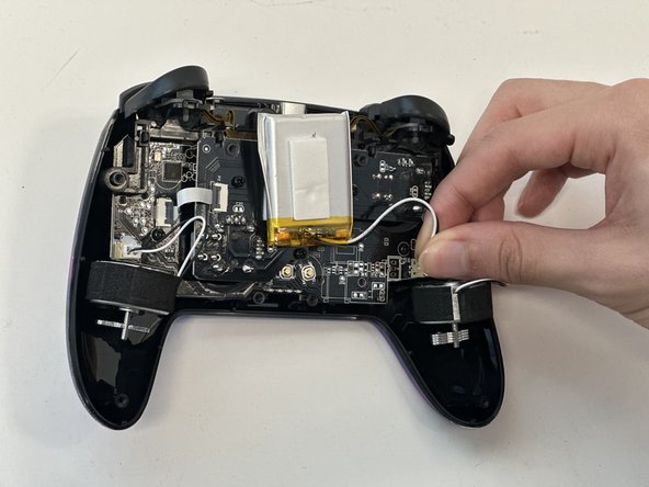

  4. NexiGo NS32 Trigger Assembly Replacement, Battery: crwdns2935265:04crwdnd2935265:01crwdnd2935265:02crwdne2935265:0 NexiGo NS32 Trigger Assembly Replacement, Battery: crwdns2935265:04crwdnd2935265:02crwdnd2935265:02crwdne2935265:0
    • Grip the white battery connector and pull it directly out of its motherboard socket.
    • This may require some force, as the connectors are secured with a bit of adhesive. If you're having trouble with disconnection, apply some high-concentration isopropyl alcohol to the adhesive to loosen it.
    • Do not pull on the wires.
  5. NexiGo NS32 Trigger Assembly Replacement: crwdns2935265:05crwdnd2935265:01crwdnd2935265:03crwdne2935265:0 NexiGo NS32 Trigger Assembly Replacement: crwdns2935265:05crwdnd2935265:02crwdnd2935265:03crwdne2935265:0 NexiGo NS32 Trigger Assembly Replacement: crwdns2935265:05crwdnd2935265:03crwdnd2935265:03crwdne2935265:0
    • Lift the battery up and out.
    • Take care not to bend or puncture the battery as you remove it.

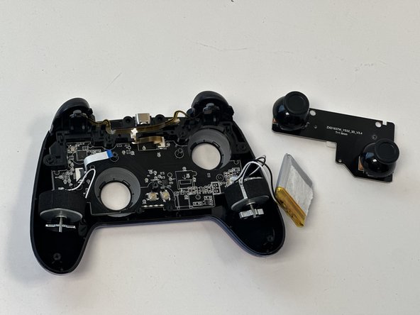

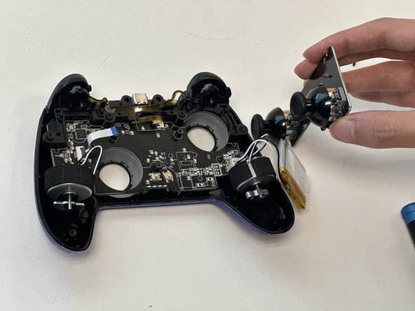

    • Remove the three 9 mm Phillips screws that secure the joystick PCB.
  7. NexiGo NS32 Trigger Assembly Replacement: crwdns2935265:07crwdnd2935265:01crwdnd2935265:02crwdne2935265:0 NexiGo NS32 Trigger Assembly Replacement: crwdns2935265:07crwdnd2935265:02crwdnd2935265:02crwdne2935265:0
    • Flip up the black ZIF connector locking flap on the left side of the joystick PCB.
    • Pull the ribbon cable directly out of its socket.
  8. NexiGo NS32 Trigger Assembly Replacement: crwdns2935265:08crwdnd2935265:01crwdnd2935265:03crwdne2935265:0 NexiGo NS32 Trigger Assembly Replacement: crwdns2935265:08crwdnd2935265:02crwdnd2935265:03crwdne2935265:0 NexiGo NS32 Trigger Assembly Replacement: crwdns2935265:08crwdnd2935265:03crwdnd2935265:03crwdne2935265:0
    • Lift out the joystick PCB.

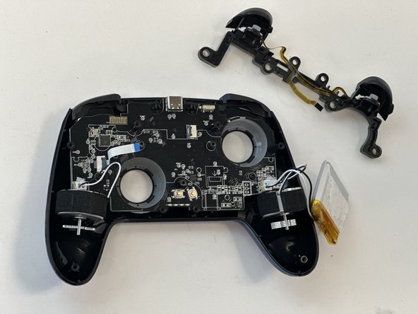

  9. NexiGo NS32 Trigger Assembly Replacement, Trigger Assembly: crwdns2935265:09crwdnd2935265:01crwdnd2935265:01crwdne2935265:0
    • Flip up the black ZIF locking flap that secures the trigger assembly ribbon cable.
    • Disconnect the ribbon cable.
  10. NexiGo NS32 Trigger Assembly Replacement: crwdns2935265:010crwdnd2935265:01crwdnd2935265:02crwdne2935265:0 NexiGo NS32 Trigger Assembly Replacement: crwdns2935265:010crwdnd2935265:02crwdnd2935265:02crwdne2935265:0
    • Gently lift out the trigger assembly.
