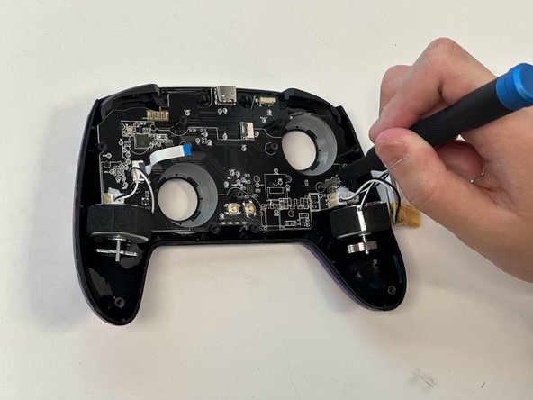

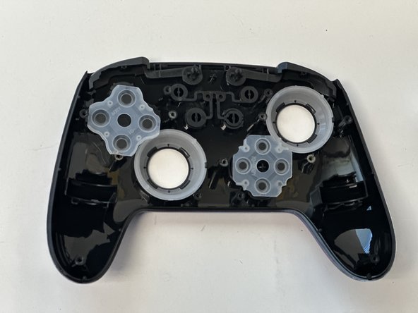

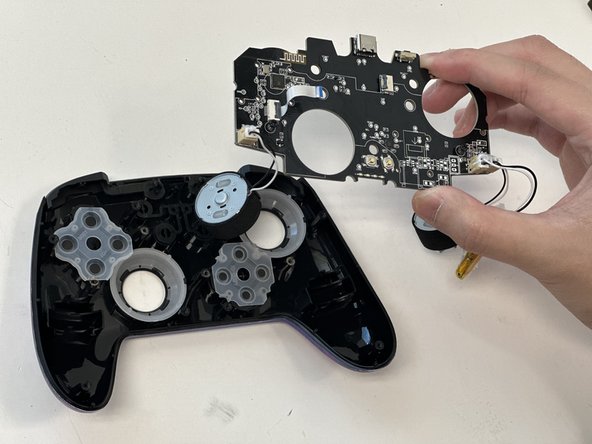

  11. NexiGo NS32 Motherboard Replacement, Motherboard: crwdns2935265:011crwdnd2935265:01crwdnd2935265:02crwdne2935265:0 NexiGo NS32 Motherboard Replacement, Motherboard: crwdns2935265:011crwdnd2935265:02crwdnd2935265:02crwdne2935265:0
    • Remove the two 9 mm Phillips screws that secure the motherboard to the front case.
  12. NexiGo NS32 Motherboard Replacement: crwdns2935265:012crwdnd2935265:01crwdnd2935265:03crwdne2935265:0 NexiGo NS32 Motherboard Replacement: crwdns2935265:012crwdnd2935265:02crwdnd2935265:03crwdne2935265:0 NexiGo NS32 Motherboard Replacement: crwdns2935265:012crwdnd2935265:03crwdnd2935265:03crwdne2935265:0
    • Gently lift the motherboard up and out the chassis.
    • Take care not to strain the vibration motor cables.
