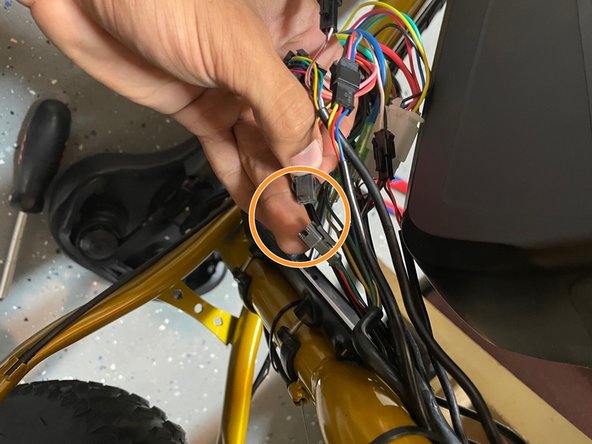

  6. New Speed 26-inch Electric Bike Throttle Replacement: crwdns2935265:06crwdnd2935265:01crwdnd2935265:02crwdne2935265:0 New Speed 26-inch Electric Bike Throttle Replacement: crwdns2935265:06crwdnd2935265:02crwdnd2935265:02crwdne2935265:0
    • Unwrap the cable lining surrounding the throttle cable.
    • Track the throttle cable to the control box.
    • Disconnect the JST-SM connector from the main controller.
    • Take caution while handling these wires. They can be easily damaged.

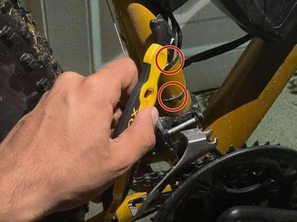

  7. New Speed 26-inch Electric Bike Throttle Replacement: crwdns2935265:07crwdnd2935265:01crwdnd2935265:02crwdne2935265:0 New Speed 26-inch Electric Bike Throttle Replacement: crwdns2935265:07crwdnd2935265:02crwdnd2935265:02crwdne2935265:0
    • Cut the zip ties found along the frame of the bike.
    • Remove the throttle and its wires from the frame of the bike.
    • Be careful not to cut too close to the wires, as you could risk damaging them or hurting yourself.
