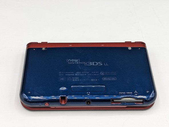

    • Ensure that the system is turned OFF.
    • Place the device on a hard surface with the rear panel facing you.
    • Unscrew the two 2.0 mm screws in a counterclockwise motion using a Phillips #00 screwdriver.
    • A "click" sound will be made after each successful unscrewing.
  2. New Nintendo 3DS XL Top and Bottom Outer Casing Replacement: crwdns2935265:02crwdnd2935265:01crwdnd2935265:03crwdne2935265:0 New Nintendo 3DS XL Top and Bottom Outer Casing Replacement: crwdns2935265:02crwdnd2935265:02crwdnd2935265:03crwdne2935265:0 New Nintendo 3DS XL Top and Bottom Outer Casing Replacement: crwdns2935265:02crwdnd2935265:03crwdnd2935265:03crwdne2935265:0
    • Pry open the wedges of the rear case by using a pick.
    • Unhinge the corners with a pick if the case is not coming loose easily.
    • Detach the rear case by pulling it away from the device.

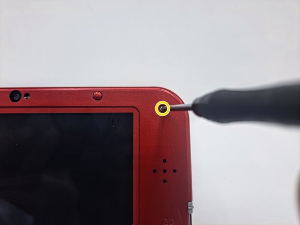

    • Flip the device over to its top side and open its lid.
    • Be careful when using the tools close to the screen.
    • Remove the rubber pieces with the help of tweezers.
    • Unscrew the 2.0 mm screws in a counterclockwise motion with a Phillips #00 screwdriver.

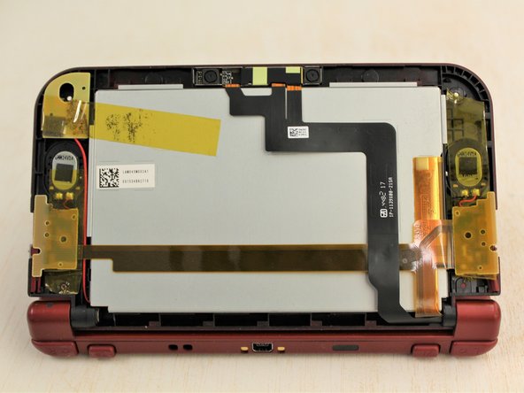

  5. New Nintendo 3DS XL Top and Bottom Outer Casing Replacement: crwdns2935265:05crwdnd2935265:01crwdnd2935265:02crwdne2935265:0 New Nintendo 3DS XL Top and Bottom Outer Casing Replacement: crwdns2935265:05crwdnd2935265:02crwdnd2935265:02crwdne2935265:0
    • Close the device's lid and position it so that the top panel is facing towards you.
    • From the hinge, slide the outer portion of the top shell so that it separates from the inner portion.
    • Once the casing is loose, detach the top case by lifting the casing off.

This is wrong for the top cover. You have to slide it out and be careful with how two little locks slot back in on the back side.
https://youtu.be/lQ1qtj5N1p0?si=Pkeq6PoT...
ravenrue - crwdns2934203:0crwdne2934203:0
I think this guide really needs updating, it basically caused me to mash my replacement shell because it's not very clear on reassembly.
