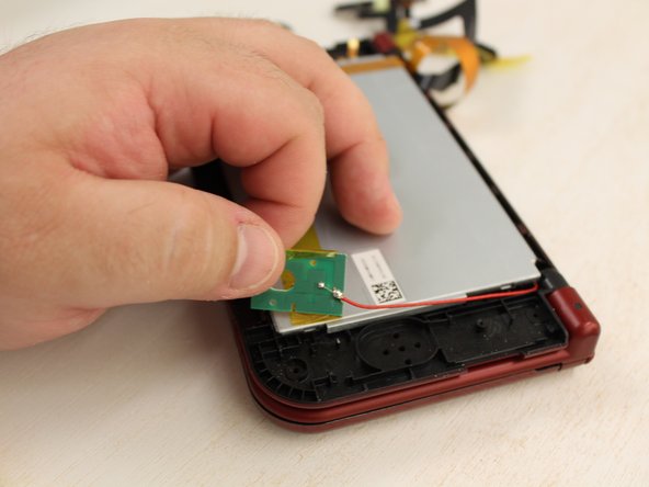

  21. New Nintendo 3DS XL 2015 WIFI Antenna Replacement, WIFI Antenna: crwdns2935265:021crwdnd2935265:01crwdnd2935265:02crwdne2935265:0 New Nintendo 3DS XL 2015 WIFI Antenna Replacement, WIFI Antenna: crwdns2935265:021crwdnd2935265:02crwdnd2935265:02crwdne2935265:0
    • From the bottom of the DS, unclip the gold clip from the motherboard, and pull the antenna out slightly so it won't get caught on anything.
    • The antenna is soldered onto a small board. Easily pull the antenna till it is out of the DS.
    • This will make soldering a new antenna much easier.
