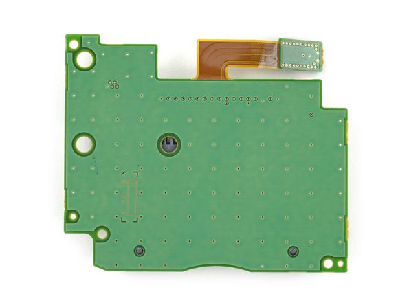

  16. New Nintendo 3DS XL 2015 Teardown: crwdns2935265:019crwdnd2935265:01crwdnd2935265:03crwdne2935265:0 New Nintendo 3DS XL 2015 Teardown: crwdns2935265:019crwdnd2935265:02crwdnd2935265:03crwdne2935265:0 New Nintendo 3DS XL 2015 Teardown: crwdns2935265:019crwdnd2935265:03crwdnd2935265:03crwdne2935265:0
    • Oh hey, the button board comes out!
    • The ABXY buttons are right on the board, but the C stick can come and go as it pleases.
    • Said C stick doesn't actually move or push anything, and therefore seems to be powered by magic.
    • You nudge it with your finger, and the 3DS just knows. Our best guess is that this actually uses strain gauges to sense how hard you're pushing.
    Don't try to dissasemble it! I've tried, then I had to glue it back and it is not functioning now :(
    DJ Oguretz - crwdns2934203:0crwdne2934203:0
    It looks as if the circle pad and c stick use the same connectors would it be possible to replace the c stick with the circle pad and move said circle pad under the buttons?
    Thezombielord47 - crwdns2934203:0crwdne2934203:0
    can you replace the c stick, specifically the rubber part? if so, how? i couldn't seem to find a guide of yours on it.
    bee - crwdns2934203:0crwdne2934203:0

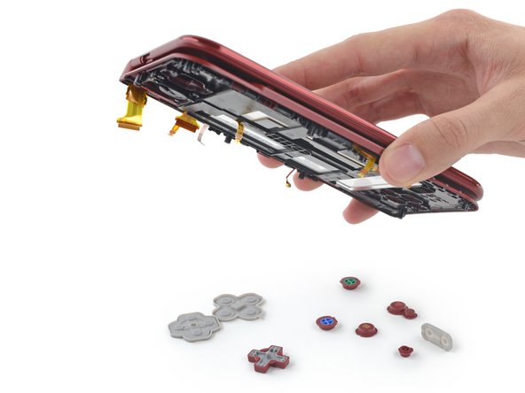

  17. New Nintendo 3DS XL 2015 Teardown: crwdns2935265:020crwdnd2935265:01crwdnd2935265:02crwdne2935265:0 New Nintendo 3DS XL 2015 Teardown: crwdns2935265:020crwdnd2935265:02crwdnd2935265:02crwdne2935265:0
    • With the cartridge reader out of the way, we easily remove the D-pad buttons.
    • Fastest way to get half a dozen button covers out of a half-disassembled 3DS XL?
    • (Shake, Shake, Shake) Shake Your Buttons.

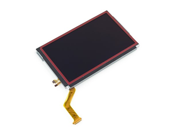

  18. New Nintendo 3DS XL 2015 Teardown: crwdns2935265:021crwdnd2935265:01crwdnd2935265:02crwdne2935265:0 New Nintendo 3DS XL 2015 Teardown: crwdns2935265:021crwdnd2935265:02crwdnd2935265:02crwdne2935265:0
    • The lower screen has a large black frame, perhaps as a defense against over-eager tapping.
    • This frame also houses what appears to be the NFC antenna for Amiibo figurines.
    • Always one to stay hip with the kids, Nintendo has expanded beyond AR cards to the collect-to-game cash cow.

    • Poppin' the lower LCD off some adhesive seems scary, but isn't too bad. No heat required!
    • There's a protective plastic film over the lower screen, both to protect the LCD and enable the touch action, so we feel pretty safe pushing on it.
    • The plastic LCD cover is threaded with a very-faintly-visible grid of dots. We didn't notice it at first, and taking a photo of it is near impossible — but it's there! We promise!
    • Resistive touchscreens like this one rely on contact between two layers of resistive material to register a touch. This way you can use a capacitative-touch-unfriendly stylus.

  22. New Nintendo 3DS XL 2015 Teardown: crwdns2935265:025crwdnd2935265:01crwdnd2935265:03crwdne2935265:0 New Nintendo 3DS XL 2015 Teardown: crwdns2935265:025crwdnd2935265:02crwdnd2935265:03crwdne2935265:0 New Nintendo 3DS XL 2015 Teardown: crwdns2935265:025crwdnd2935265:03crwdnd2935265:03crwdne2935265:0
    • Let's just remove the camera bar. Oh wait.
    • There are several cables leading into the side of the display assembly. Our bet is that these control the parallax barrier, used to generate that awesome glasses-less 3D effect.
    • What's a parallax barrier? Imagine placing a very small picket fence in front of your screen, so that when you look at the display, each eye sees different pixels while they peer around the fence boards.
    • Then, with a combination of the magic of geometry, and the new face-tracking "super-stable 3D", the 3DS knows which pixels each eye can see, and draws two overlapping versions of the same scene—one for each eye. The combination of these two versions gets slapped together in your thinkpan as a sweet, sweet stereoscopic 3D image.
  23. New Nintendo 3DS XL 2015 Teardown: crwdns2935265:026crwdnd2935265:01crwdnd2935265:03crwdne2935265:0 New Nintendo 3DS XL 2015 Teardown: crwdns2935265:026crwdnd2935265:02crwdnd2935265:03crwdne2935265:0 New Nintendo 3DS XL 2015 Teardown: crwdns2935265:026crwdnd2935265:03crwdnd2935265:03crwdne2935265:0
    • Good news: The display assembly is only mildly adhered to the frame, meaning we can pop it free with little effort.
    • Bad news: Its ribbon cable, and two others, are routed through the hinge, and need to be rolled up and pulled through in a horrible, painstaking, risky maneuver.
    • But then it's free!
    Does anyone knows if the upper LCD screen is the same of the 3DS XL? If I substitute a New 3DS XL broken upper LCD for a working LCD from a 3DS XL will it work (plus the eye tracking)?

    • The headphone jack and charging connector are soldered to the motherboard, meaning you need to take out your soldering iron if you accidentally break them.
