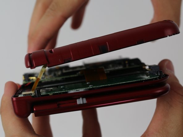

    • To pry off the cover, carefully lift it up and away from the hinges (in order to clear the headphone port), then pivot it towards the hinges to expose the circuit boards.
  8. New Nintendo 3DS XL 2015 A,B,X,Y, Start or Select Button Replacement: crwdns2935265:08crwdnd2935265:01crwdnd2935265:01crwdne2935265:0
    • Use non-conductive tweezers to disconnect the two ribbon plugs that connect the L/R/ZL/ZR buttons on the cover to the motherboard, then remove it completely. Or, use the flat end of a spudger to pop them off.

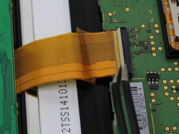

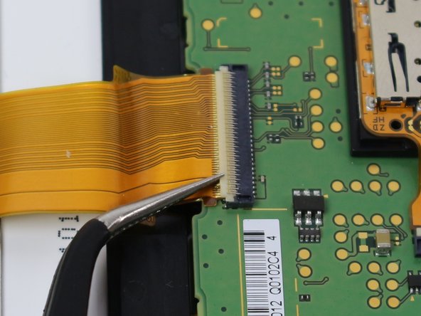

    • Locate the ribbon connector between the motherboard and the left circuit board (it should be the widest) and use a pair of tweezers or the flat end of a spudger to pivot up the ZIF clasp upward.
    • The ribbon can be removed using non-conductive tweezers by pulling out parallel with the board.
