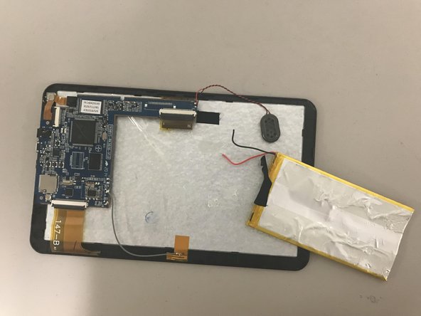

    • Insert plastic spudger underneath the edges of the battery to pry it up and detach the adhesive.

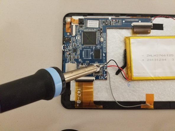

  3. NeuTab N9 Battery Replacement: crwdns2935265:03crwdnd2935265:01crwdnd2935265:03crwdne2935265:0 NeuTab N9 Battery Replacement: crwdns2935265:03crwdnd2935265:02crwdnd2935265:03crwdne2935265:0 NeuTab N9 Battery Replacement: crwdns2935265:03crwdnd2935265:03crwdnd2935265:03crwdne2935265:0
    • Completely remove the battery from the device by desoldering the red and black wires from the motherboard.
    • Follow these instructions if you do not already know how to desolder.
