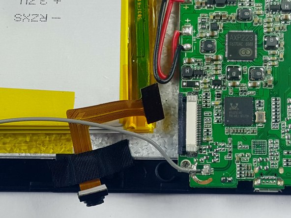

      • Power off your device before beginning disassembly
      • Insert plastic opening tool and pry back case away, slowly moving the plastic opening tool along the device.
    2. NeuTab N7 Pro Camera Replacement: crwdns2935265:02crwdnd2935265:01crwdnd2935265:01crwdne2935265:0
      • Locate the camera unit and note where it is attached to the motherboard.
      • Use a black nylon spudger to remove the adhesive holding it onto to the motherboard.
      • Metal tools can puncture an unprotected battery, potentially causing a fire. When working with electronics, it's important to choose a tool that's ESD-safe to avoid accidental damage to the device.
    3. NeuTab N7 Pro Camera Replacement: crwdns2935265:03crwdnd2935265:01crwdnd2935265:02crwdne2935265:0 NeuTab N7 Pro Camera Replacement: crwdns2935265:03crwdnd2935265:02crwdnd2935265:02crwdne2935265:0
      • Use a black nylon spudger or tweezers to release the connector holding the camera ribbon cable in place.
      • Carefully pull the ribbon cable out, removing the camera from the motherboard.
