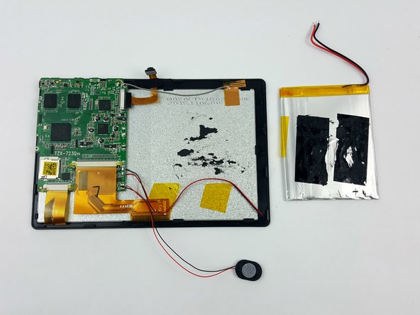

NeuTab N7 Pro Battery Replacement
  1. NeuTab N7 Pro Battery Replacement, Battery: crwdns2935265:01crwdnd2935265:01crwdnd2935265:01crwdne2935265:0
    • Power off your device before beginning disassembly.
    • Insert plastic opening tool and pry back case away from the device, slowly moving the plastic opening tool along the device.
  2. NeuTab N7 Pro Battery Replacement: crwdns2935265:02crwdnd2935265:01crwdnd2935265:01crwdne2935265:0
    • Follow the red and black wires from the battery to where they are soldered to the motherboard.
    • Warning: Use caution when handling a soldering iron to avoid injury or damage.
    • Use a soldering iron to separate the positive and negative wires from the motherboard.
    • For a complete guide on how to solder, click here.
  3. NeuTab N7 Pro Battery Replacement: crwdns2935265:03crwdnd2935265:01crwdnd2935265:02crwdne2935265:0 NeuTab N7 Pro Battery Replacement: crwdns2935265:03crwdnd2935265:02crwdnd2935265:02crwdne2935265:0
    • Insert plastic spudger under the battery and slide back and forth, separating the battery from the case.
