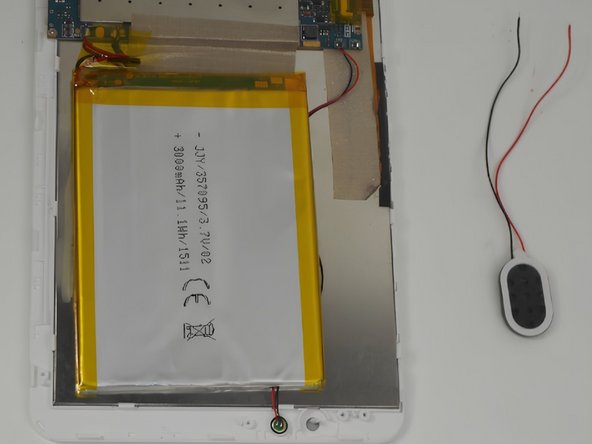

  1. NeuTab Air7 Speaker Replacement, Back Cover: crwdns2935265:01crwdnd2935265:01crwdnd2935265:03crwdne2935265:0 NeuTab Air7 Speaker Replacement, Back Cover: crwdns2935265:01crwdnd2935265:02crwdnd2935265:03crwdne2935265:0 NeuTab Air7 Speaker Replacement, Back Cover: crwdns2935265:01crwdnd2935265:03crwdnd2935265:03crwdne2935265:0

  2. NeuTab Air7 Speaker Replacement, Speaker: crwdns2935265:02crwdnd2935265:01crwdnd2935265:02crwdne2935265:0 NeuTab Air7 Speaker Replacement, Speaker: crwdns2935265:02crwdnd2935265:02crwdnd2935265:02crwdne2935265:0
    • The following instructions require soldiering, which can risk burn injuries as well as component damage for those novice in the skill. Tread with caution.
    • For a guide on how to solder, click here.
    • De-solder the red and black wire ends that connect the speaker to the motherboard.

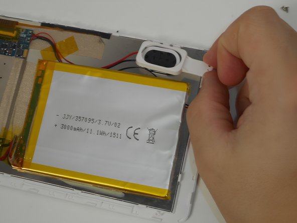

  3. NeuTab Air7 Speaker Replacement: crwdns2935265:03crwdnd2935265:01crwdnd2935265:03crwdne2935265:0 NeuTab Air7 Speaker Replacement: crwdns2935265:03crwdnd2935265:02crwdnd2935265:03crwdne2935265:0 NeuTab Air7 Speaker Replacement: crwdns2935265:03crwdnd2935265:03crwdnd2935265:03crwdne2935265:0
    • Use a Phillips #00 screwdriver to remove the two 0.8 mm screws holding the cover of the speaker in place.
    • Remove the cover and the speaker.
