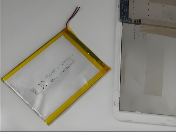

NeuTab Air7 Battery Replacement
  1. NeuTab Air7 Battery Replacement, Back Cover: crwdns2935265:01crwdnd2935265:01crwdnd2935265:03crwdne2935265:0 NeuTab Air7 Battery Replacement, Back Cover: crwdns2935265:01crwdnd2935265:02crwdnd2935265:03crwdne2935265:0 NeuTab Air7 Battery Replacement, Back Cover: crwdns2935265:01crwdnd2935265:03crwdnd2935265:03crwdne2935265:0
    • Ensure your device is powered off before you begin.
    • Use the opening tool to gently pry the back cover off of the tablet, running it along the perimeter of the device.
  2. NeuTab Air7 Battery Replacement, Battery: crwdns2935265:02crwdnd2935265:01crwdnd2935265:02crwdne2935265:0 NeuTab Air7 Battery Replacement, Battery: crwdns2935265:02crwdnd2935265:02crwdnd2935265:02crwdne2935265:0
    • The following instructions require soldering, which can risk burn injuries as well as component damage for those novice in the skill. Tread with caution.
    • For a guide on how to solder, click here.
    • Remove any adhesive tape that is holding the wires protruding from the battery down.
    • De-solder the red and black wire ends that connect the battery to the motherboard.
  3. NeuTab Air7 Battery Replacement: crwdns2935265:03crwdnd2935265:01crwdnd2935265:02crwdne2935265:0 NeuTab Air7 Battery Replacement: crwdns2935265:03crwdnd2935265:02crwdnd2935265:02crwdne2935265:0
    • Using metal tools can cause damage to the battery and potentially create a fire hazard. ESD safe tools are recommended for this operation.
    • Wedge a plastic or nylon spudger underneath the battery, moving it back and forth to separate it from the device.
    • Remove the battery.
