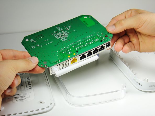

  5. Netgear WGR614v9 Motherboard Replacement, Motherboard: crwdns2935265:05crwdnd2935265:01crwdnd2935265:01crwdne2935265:0
    • Remove the clear plastic casing by lifting it straight up from the router.
  6. Netgear WGR614v9 Motherboard Replacement: crwdns2935265:06crwdnd2935265:01crwdnd2935265:02crwdne2935265:0 Netgear WGR614v9 Motherboard Replacement: crwdns2935265:06crwdnd2935265:02crwdnd2935265:02crwdne2935265:0
    • Separate the motherboard from the top shell by lifting it straight up from the router.
